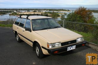

Enter the beige wagon below. Saw in trading post and thought I would give a call. Advertised at 1500 bucks. Got on to the guy last Wednesday who indicated that yes it was still for sale with rego due and him heading back to Norway on Friday. No rust he says, mechanically good, never let him down etc etc. OK - I'll give you 600. Done, come down on Saturday and give the money to my neighbour. Righto, you fill out the paperwork and all is good.
Get down to pick up on Saturday afternoon. Not as good as pictures. Five speed single range - bummer. Dusty bird crap covered body. Hey its been resprayed, not what I wanted - bog - yep. Pretty straight though, and interior really good. Base model means vinyl floor and hard wearing everything. All good and perfect for what I need. Windscreen perfect. Two new front tyres.
Open bonnet. Came belts replaced 20k ago. Coolant in radiator. 240k all up. Some oil leaks but nothing major. All good. Has air but no power steering.
Start her up. Noisy lifters - check. Sloppy gear change - check. Too much clutch pedal free play - check.
OK we are away. Clutch is ok, change gear and then clunk through the steering. Almost like it has a missing engine mount but I can feel it through the steering. Right thats gunna need some investigation.
Everything else OK. New CD player works, but aircon no. A bit clunky in the suspension, but still this steering thump and crash. Still after a stop 2km down the road for fuel (he'd left almost a full tank) and a wash we are heading the 150km back to Ballarat. No great drama. Stop at a dirt road, and push button 4wd activation works a treat. Sits on 110 with no drama's. Intermittent lifter noise drowned out by cd player. CV's seem good.
Get back to my place and its dark. But I can see that there is a bit of bog and some rust coming through in the rear wheel wells, nothing major but its there. Everything is pretty straight though and it does seem like I could be onto a winner. I decide to have a better look the next day.
Sunday and I have a couple of hours to play. Paints faded so do a 1/2 hour cut an polish - comes up sweet. Then put her up on stands to work out this steering issue. OK, left hand steering rack bush has slipped out of the bracket meaning steering rack has about an inch of movement on that side. That explains it. Bush is still there and looks OK. 5 min to put back where it is meant to be. OK now things are looking up.
Run some flushing compound through the engine for 20 min and drain the oil. Put in some new oil I had in the shed. Lifters better, but not great. New oil filter and magnetec next weekend.
Jobs to do. Bled brakes. Some suspension bushes. Drain and refill cooling system. Adjust clutch. Fix gear shift. Already sourced a set of Pug 505 rims with large centre hole, through my puggy mates.
Total cost so far - $606. Budget - $1000. I'll keep you posted and look forward to being one of the gang.
