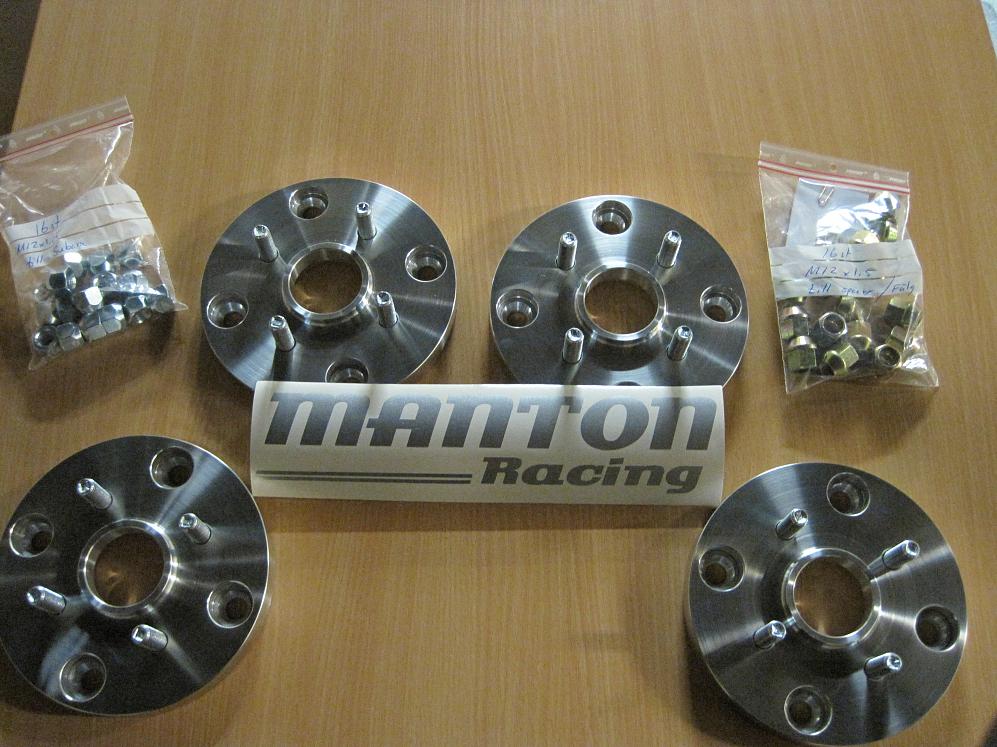

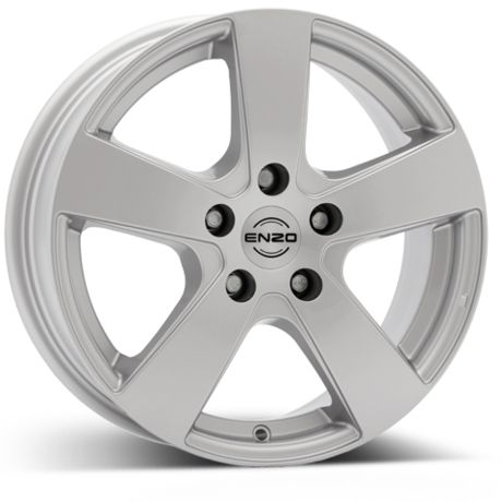

i will use 20mm spacers to change bolt pattern to 100x4, the rims i will use have ET 50,, so slightly wider track width ( if i´m correct 17 mm on each side )..Picture shows 5 bolt rims

The big Q is what tire size i can run,, i like to be on the safe side as for clutch and gearbox stress,, and still go up a few sizes for clearance and traction in snow.

Shame you were forced to run the rim spacers to get the rims you need. Are they steel? You need to keep a close watch on them as the nuts can work loose and, hidden behind the rim it's impossible to tell. The steel ones are better than the alloy spacers but they can all let you down. I would never use them on a comp car if I had a choice.
I know an un-lifted Brumby will have enough clearance to run 185/70R14 which is only about 24" tall. You could try to squeeze in a 185/75R14 or 195/70R14 or 205/65R14 which are a bit taller but that's about it before you'll need to start trimming the sheetmetal fenders.
My advice it to find out if you are permitted to fit a body lift because they are well worth it and then run 185R14, 195R14 or my favourite, the 27x8.5R14.

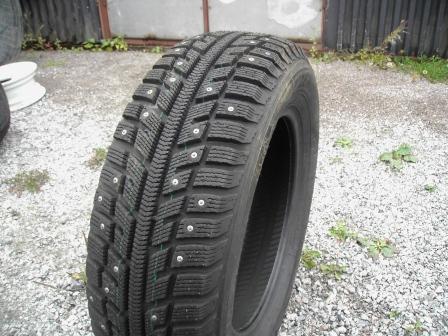

Was thinking of using 195-65-15, studded winter tires kumho kw22,,
aprox 25" tall, nice tire pattern for a small tire,, road legal also..

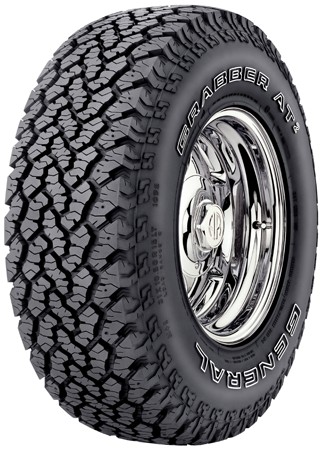

I could go with studded general tire grabber AT2,, 27" tall..
not as god in snow but still legal as a winter tire, the pro is that it´s bigger,,
tire pattern as the BFgoodrich All Terrain, but softer rubber, and studdable.
still worried about it beeing to big,, stress issues on the transmission/driveline,,
see pictures of the tires

my wheel nuts work loose anyway.brumbyrunner wrote:So no body lift then? Bummer.
the problem i have with wheel spacers is that they can cock on the studs, wheel nuts go tight but the wheel isnt really on the hub. also this can bend the studs and cause them to break which sucks in the middle of a race or rally

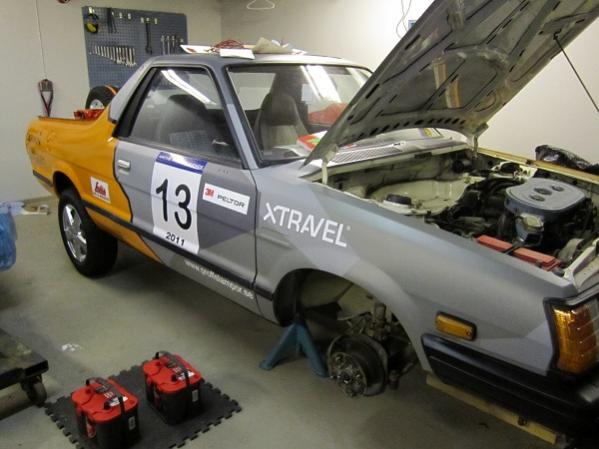

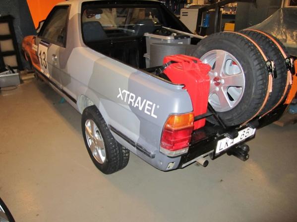

Check out my website for updates,, i´m painting the car right now..
http://www.underdog-motorsports.com

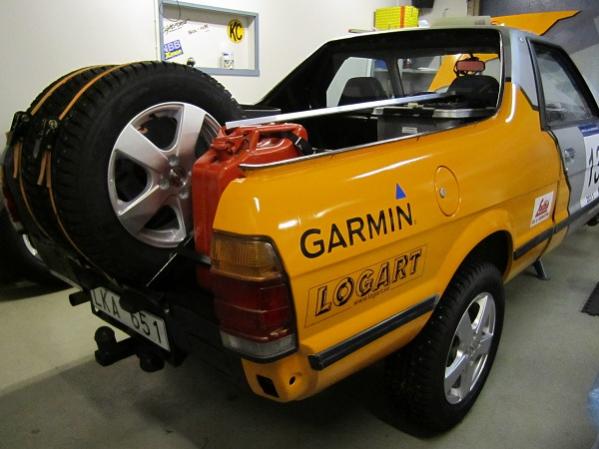

Car painted
Finally painted,,
Linus,,
Linus,,
- IMG_0565.jpg (40.03 KiB) Viewed 6279 times
- IMG_0562.jpg (36.62 KiB) Viewed 6279 times
- IMG_0564.jpg (39.19 KiB) Viewed 6282 times

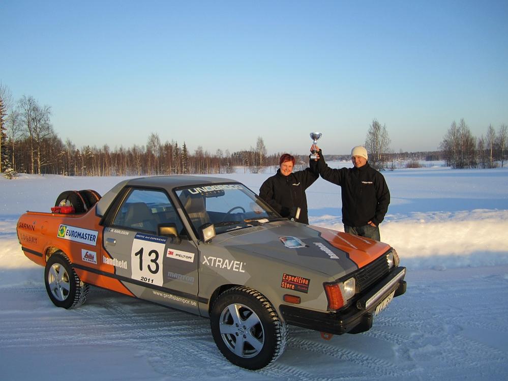

Jihaaaa finished on third place overall,, i will post pics and write about the adventure on my website, just wanted to show you my adventure brumby,, updating my website in a couple of hours, remember this is not a race car,, next one will be for sure..
Linus,,
Linus,,
- IMG_0912.jpg (85.58 KiB) Viewed 6279 times
It was tough keeping it warm inside the car, -25 to -38 degrees celcius every day,, also got some vibrations on the last day of the adventure, it started when driving about 80 km/hour ( 50 mph )
