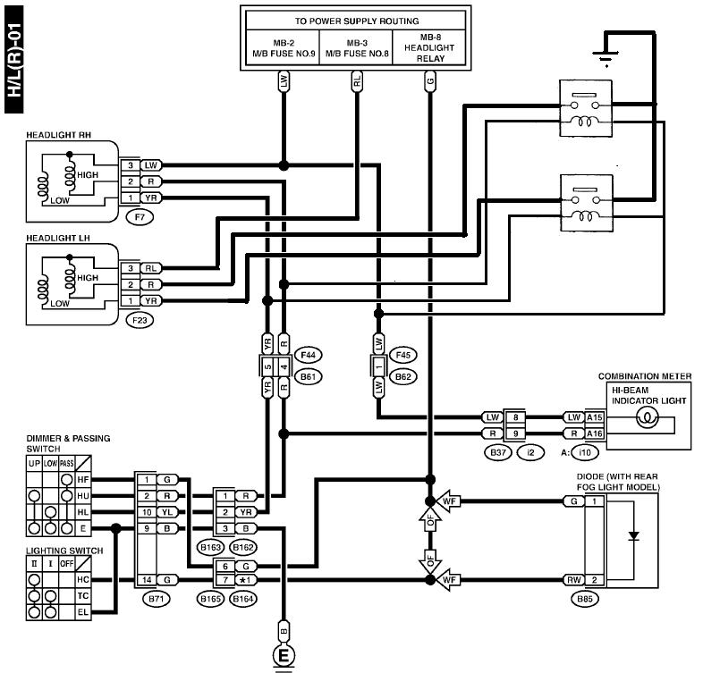

This should get you out of trouble.
Ive only shown the left hand wiring and left the right hand as original to show how it was. You should also pick up a feed for the lights from a new fuse and disregard the cars original light fuse

thx Gannon. i will try to decipher this lol.
sorry 2b a pain but would you have complete before & after wiring diagrams? from other diagrams iv seen the right & left sides are wired differently! i'm having a lot of probs getting my head around this "different" wiring system!
Have you had any problems with the high beam indicator light as i hav heard of so many ppl having probs wth high beam not switching off & the indicator light never turning off.
Also, can u identify the wires going into the H4 connectors for me?
they are as follows:
LHS: yellow/red; red; red/blue
RHS: yellow/red; red/black; blue/white.
many thx,
matt
Post by Gannon » Thu Sep 01, 2011 6:15 am
Ok, I'll mock up another wiring diagram this afternoon after I get home from work.
The colours are already on the wires in the above diagram.
LW = Blue/white
R = Red
YR = Yellow/red
RL = Red/blue
Post by NachaLuva » Thu Sep 01, 2011 11:54 pm
thx Gannon,
Ok, i think i undrstnd ur diagram...i think lol. But im still pretty nervous cos iv heard of heaps of disasters like no switchng between high/low, indicator light stayng on, etc, when this has bn attempted. & once i start its not like i can just undo it lol.

Post by NachaLuva » Sun Sep 11, 2011 5:35 pm
After much staring at Gannons wiring diagram, plus others i have found, i've come up with a schematic that i'm confident will work (famous last words lol).
I'll be using a relay for battery positive triggered by light switch, 1 relay for each of low & high beam (earth) controlled by dip switch, & another relay for driving lights, run off high beam & dash mounted switch.

Post by NachaLuva » Thu Sep 15, 2011 6:16 pm
pitrack_1 wrote:...my head started to spin. How difficult they can make 12V, switches and lamps! :shock:
Yes it did!!! :shock:
It would be so much easier if subies were wired normally but apparently this way increases efficiency...not quite sure why. Its how they get away with such tiny diameter wire.
Steptoe was kind enough to send me a PM explaining how to do it,,,it still seems complicated but i will give it a go.
What i would also like to do is post my wiring diagram (provided it works lol) to help others with the same prob but i dont know how Gannon does them on the computer. Mine are just hand-drawn.
