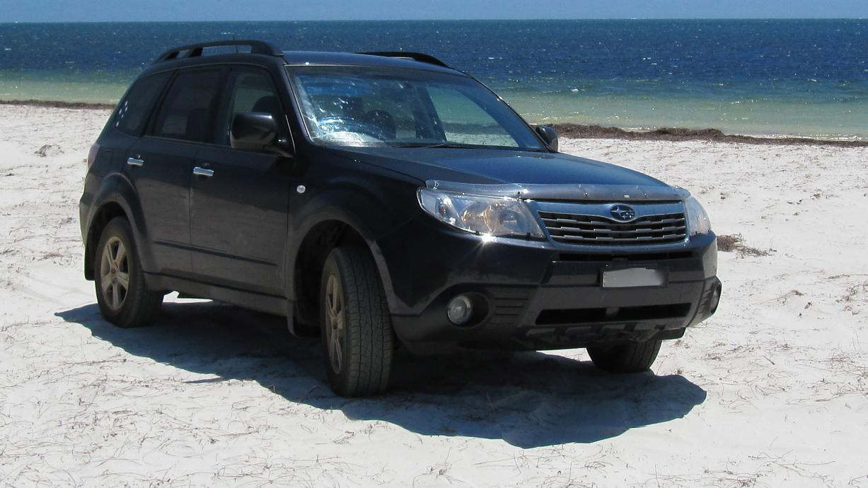

I think I saw from your photo you have the original Bridgestone Dueler H/T 687s? See what happened to me. One dead tyre may mean 4 new ones (or you can stuff the AWD system). If you're going to be off-tarmac a lot, watch out and run lower pressures (30psi i've been recommended) or get better ones.
Have fun and don't destroy anything on that shiny forester!

Post by Jerrad » Sat Feb 25, 2012 10:48 am
Thanks heaps pitrack!
That photo was taken a little ago over in WA, all my new pic's seem to be from the back or side corners. I have changed my tyres to 'Cooper CS4' a while ago and no problems off road so far! Need to get some new rims and some AT's for some real offroad.
Iv had a little busy morning but am hoping to get into it now!
