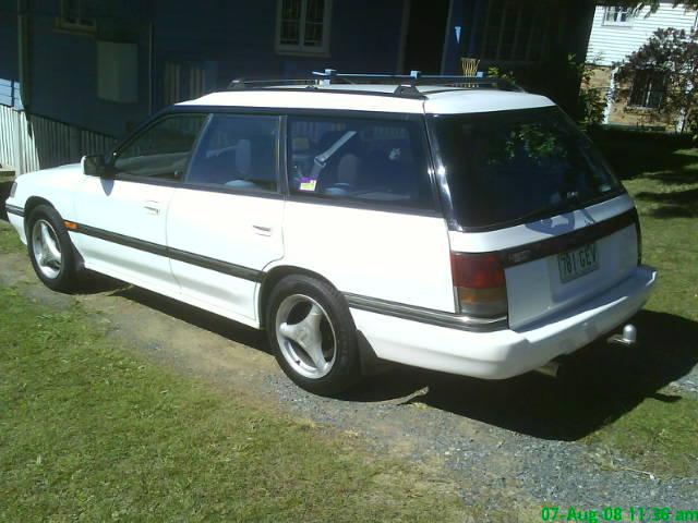

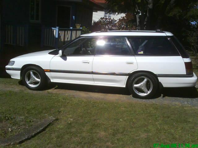

Post by tee gee » Thu Aug 07, 2008 11:42 am
Here's some photos of my car

Post by Suby Roo » Thu Aug 07, 2008 12:10 pm
Very nice!! I like those Wheels!

Post by BrennyV » Thu Aug 07, 2008 3:52 pm
nice clean lookn gen 1! go the 3spoke mags ;)

Post by Captain Obvious » Thu Aug 07, 2008 4:11 pm
hi tee gee, nice looking wagon you have there,
towing your (dog wash?) trailer should be fine behind that car, the high tow ball compensates for the car being low. if it has no air bags it should be fairly cheap and easy to put king springs in, maybe see how it goes for a few weeks the way it is before rushing out and doing it.
