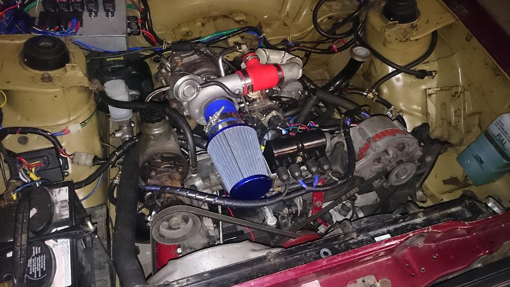

I'm sorry Mr Steptoe, I do have a few pics but it's a bit of a lashup at the moment. I wasn't even sure it would work. Seems as though it does I need to clock the compressor housing 180 degrees and mount up my intercooler. Also need an ej series throttle cable to go around the turbo and some heat shielding. This should give you the general idea though.

Post by TOONGA » Mon Apr 20, 2015 8:21 pm
Very nice Doug :)
Instead of turning the turbo, make the pipe for the intercooler turn right and go over the power steering housing, and then out the front to the intercooler.
Post by El_Freddo » Mon Apr 20, 2015 8:51 pm
Shit Doug!
That's awesome! This probably needs its own thread as I have questions about the injector setup you're running. Looks like four plus one in the throttle body for when on boost. I'm keen to know more about the four at the heads ;)
And is this your own programming of a home build ECU?

Post by Subydoug » Mon Apr 20, 2015 10:42 pm
Thats a good Idea Jules, Il have a look into it. Might have to weld a 90 onto the outlet of the compressor.
Yeah I should probably start a thread about it. Only the 4 injectors at the heads. I welded the bungs in myself (NOT for the faint of heart!). Its got a harley throttle body on it, also welded on and its all run by a microsquirt. Wasted spark and batch fire injection using speed density. My homemade ECU sucked compared to the microsquirt. Stuck the turbo on during the last week, running wastegate pressure (~7psi). When It blows up il stick some low compression pistons in it.
Doug
Post by steptoe » Tue Apr 21, 2015 8:26 am
think we all appreciate seeing the lashup devolpment stage Doug - I do :)
Did you use an EA82T exhaust and add a bit to get the turbo up at a more practical spot, or make that too ?
There are experienced nayseyers out there will say the NA comp and turbo will eventually kill your big ends first I think it is. You would be th right sort of geniuous to be able to devise a thing to relieve the turbo of a bit of steam as rev and load rise to something like just 4 psi to preserve things ?
Like your work - another action man like Tweetys Tony !!

Post by Subydoug » Wed Apr 22, 2015 1:45 pm
No, no donor turbo bits Jonno. First thing to pop will most likely be head gaskets And piston lands. I've felt 7lbs now Jonno, there ain't no going back! I plan on tuning it up a bit better this weekend.
