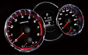

Post by Ricker » Tue Mar 29, 2011 9:09 pm
drwormy wrote:Sounds like you did really well out of it. Well done.
I feel so! Check out the new instrument panel in the 2011 xt. Looks pretty sweet
