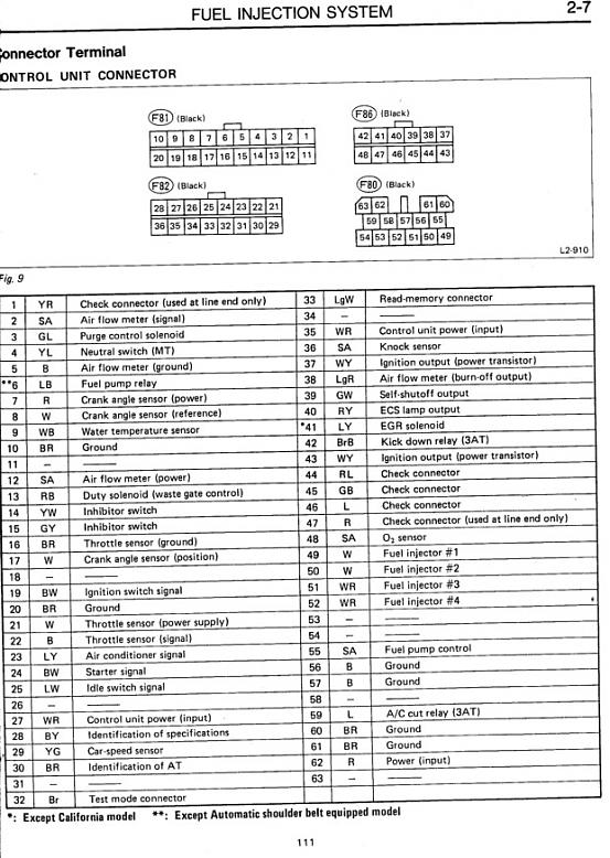

Post by T'subaru » Fri Jan 15, 2010 1:59 pm
[ATTACH]1823[/ATTACH]
1989 fsm 4 plug ecu pin outs
89 ecu pin outs.jpg (99.05 KiB) Viewed 2441 times

T'Subaru, that listing you posted is the same one as i posted - are they both from mpfi or turbo???
Post by Gannon » Sat Jan 16, 2010 6:54 am
MPFI and Turbo are exactly the same ECU pin outs. The only difference is that Turbo ECU's have extra wires for WGDS and knock sensor.

ok, so thinking out loud again, maybe we can get away with just adding a knock sensor and using the NA ecu???
the other thing i've read as well (in a fair few places) is that if we want to upgrade the injectors it can be done if you mod the MAF. for example, if you increase the injector size by 20%, you increase the MAF area by 20% as well.
the beauty of MAF is that the ecu doesnt care about if the engine is turbo or NA, all it looks at is the air flow (and at the same time the temperature) and the engine revs, then tells the ecu to fire the injectors appropriately, with input from the engine coolant temp and the o2 sensor

Looks like it will just take a knock sensor, then you hope it takes it into account, suck and see. Would also be useful to know part numbers of ecu from both turbo and na, across continents too
