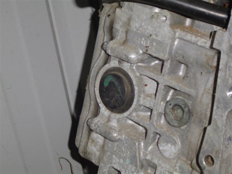

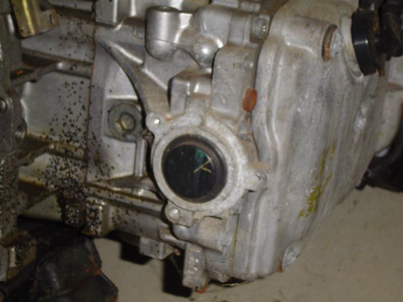

Post by Ben » Sat Feb 02, 2008 10:16 am
Ok, I've just come to an "I'm a dumb-arse" realisation.
The reason this works is that the heads are left/right interchangeable - therefore something needs to be provided on the head to mount stuff like cam gear to the head...
This is a pic of the drivers side head rear

And here is the passenger side rear.

How does that rubber bung come out?

Please watch before posting!

Post by FROG » Sat Feb 02, 2008 10:26 am
had to smack mine out from the inside when i did my heads up last week they just a press fit if you muck it up they not too xxxy from subaru usually got some sealer on it may be a little awkward to remove from outside
