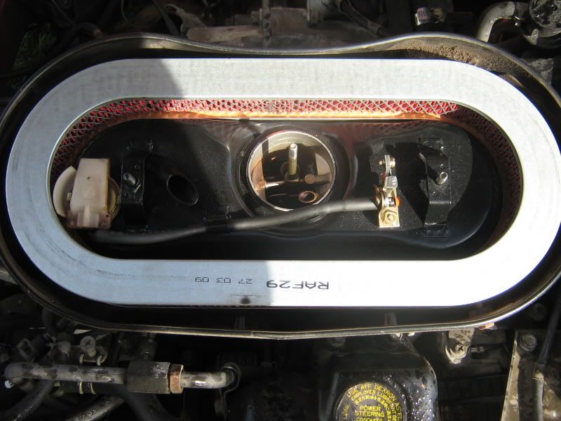

Post by 2nd Hand Yank » Sat Oct 08, 2011 1:34 pm
I just cut, filed flat the edges and re-glued a snorkel last night. :D
Pretty soon I'll get to try out my L Series with fresh air on the highway. :mrgreen:
I still want to try a dual-snorkel, if I can get away with it.
There's already an opening on the passenger side.
Look in the top-right corner of this picture.
There's a rubber valve, a oval hole behind it, and a rectangular duct on the other side of the hole.
To this, there are some hoses connected to this duct.
Some kind of emissions equipment I reckon.
I could modify this to a second snorkel,
and if I add bungs to the snorkel, I could have all my hoses connected,
making it LOOK like all emissions equipment as Subaru set it up.
Are there any possible problems with this extra snorkel I want? :???:

Post by El_Freddo » Sat Oct 08, 2011 6:09 pm
2nd Hand Yank wrote:Are there any possible problems with this extra snorkel I want? :???:
Personally the only thing would be what it looks like - as I don't like the look of dual snorkels, that's meant for trucks ;)
Another possible "problem" is forced induction, which being an EA82 wouldn't be a problem ;) :p

Post by sven '2' » Sat Oct 08, 2011 6:43 pm
2nd Hand Yank wrote: Are there any possible problems with this extra snorkel I want? :???:
This is all about the 'look'??
Dual snorkels = dual heat soak - this about metal/plastic/whatever sitting in slow moving traffic, heating up, on a balmy 42C WA day.
I had a (cough cough LJ80 with a snorkel) - was terrible in low airflow situations like sand, rock crawling etc
'Clean air' is not really an issue unless (1) H2O crossings, or (2) thousands of kms in bull dust. If it performance you are seeking, there are are (limited) mods your EA should undergo first.

Post by 2nd Hand Yank » Sat Oct 08, 2011 11:17 pm
I think I might be using the wrong term.
Count that as newbie error, not Canadian terminology.
I meant what connects the air cleaner to the fresh air opening in the driver-side fender.
I see two openings in the air cleaner assembly, one is for emissions equip on the passenger side.
My passenger fender might be good to experiment with,
because it has holes in the bottom corner already!
So what I meant was I'd like greater amounts of fresh air into the air cleaner, I thought the snorkel was any type of tubing connecting the air cleaner and I'd like to see if I could rig up a second fresh-air duct under the bonnet.
*And to cleverly-dilute the emissions that are supposed to be going back into the carby. :mrgreen:
Though I was also thinking about fender mounted, reverse facing scoops with no external ducting other than the scoops themselves; shorter ducts = less resistance to flow.
I think those large exterior snorkels are pointless unless you intend to do deep water crossings.
But I never thought about low windspeed and long, black plastic ducting, probably too hot to touch in summer sun. :p
I've watched they way utes kick up dust in summer and their higher snorkel inlet doesn't seem to help.

Post by sven '2' » Sun Oct 09, 2011 10:06 am
The std air intake is PLENTY for a stock 1.8.
I would be cleaning your airbox first - seems to be a bit of crud in there!

Post by 2nd Hand Yank » Sun Oct 09, 2011 11:18 am
sven '2' wrote:The std air intake is PLENTY for a stock 1.8.
I just realised that faster air inlet speeds possibly yield coolest possible air.
So maybe a dual duct wouldn't be better. :???:
I was just thinking about it,
when there's excessive amounts of radiant heat around it might be nice.
Yesterday, when I sat in my sunheated car,
it was a bit harder for me to breathe, all the hot air rising in my car?
I enjoy that level of heat though, but it makes me think how my motor's breathing.
I wonder if insulating the air-box would actually be more effective;
keeping more engine heat out of the air box?
Thoughts?
