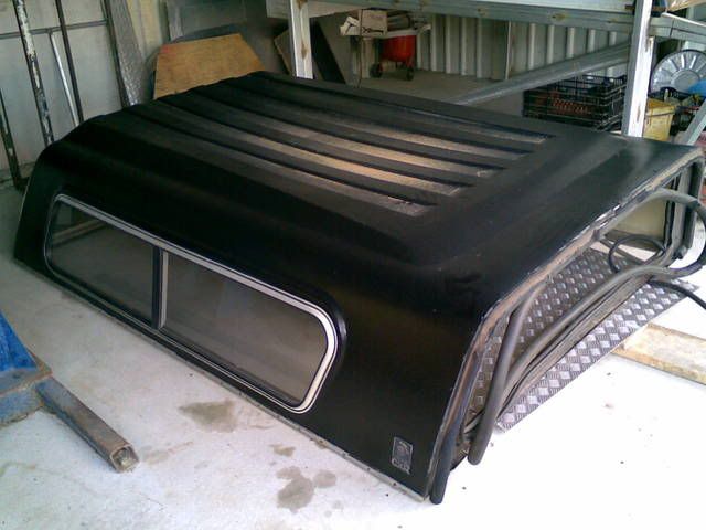

here's what i bought today. plans are making it into a camper. its a well body off the back of an import Ford F250 with a flexi glass canopy. its 8ft x 6ft and about 1100mm tall inside when canopy is on. plan is to have a roof top tent on top, use the tray/canopy for luggage/storage/dogs room, and make it with a nice extended draw bar for some custom checkerplate storage system up front.
got the tray, liner and canopy for $1100 which i reckon is a steal. gonna be making it into a basic trailer first for moving house stuff and taking stuff to the tip etc etc, then eventually make it into a camper
there is 2 outlets visible in the second photo, one will be the filler for a water tank and the other either a power plug or outlet. will probably set it up with some kind of 12v system.

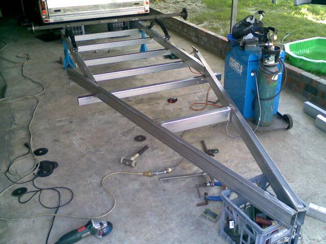

got it to my house today. Have measured and drawn up the chassis i need to mount it, nice long draw bar for future addition. found a 70L water tank that'll fit in nicely up high and between my chassis, mounting that behind the axle coz i figure when its loaded to go camping, most the weight will be in front of the axle so put it behind to counter weight.
then i just have to hitch it to the back of my car, get it level and sort out what suspension i need to keep it the same height as the car.
probably start making the chassis tomorrow depending on other commitments.

here's my progress today, ran out of gas so couldn't weld it. thats on the cards tomorrow.
only bad thing i think is the distance between the springs and the hubs. probably should have made the frame wider but too late now. I cut the steel to length at the place i bought it from so i had to stick with what i designed
