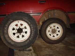

i'll duck out side place one next to the car take a photo and up load it on here.
back in 5
shuffbag
Posts: 564
Location: adelaide
Post by shuffbag » Wed Aug 13, 2008 9:02 pm
well *cough* theres not that much size differance ;)
oh and my tyres on atm are 185/75/14
might make for a fun sunday arvo. i don't want to alter to much of the visable body as i will never run tyres of this size once there gone/ if they get on at all
