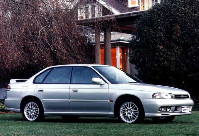

Looking to buy '98 Liberty.... What to look for??
Post by subie_1st_timer » Fri Feb 19, 2010 12:43 am
been a while since ive been here, but i will admit i did leave the subie family for a while as i got rid of the brumby for an XR8 at the end of 2008.... BUT!!! Im looking to return for some more subie lovin and im lookin at buying a 1998 SUBARU LIBERTY 2GEN MY98 RX AWD.... geez thats a mouthful lol:p
The XR8 spat a gearbox today (same day i looked at the Liberty, must be jelous lol) so definatly keen for the upgrade
Car looks great for its age, low kays @ 148000 (ave 12,300km a yr) and looks to be an upper spec model, with the fog lamps, power everything, air, P/S, Cruise, woodgrain dash etc and 2.5lt 4cyl (not sure what type of motor, EJ25 im guessing?), auto, velour trim, 15" alloy wheels. looks exactly the same as this pic but just different alloys Image
Can someone offer any info on what to look out for during the test drive, any rust/structural issues, anything to do with the AWD system etc etc.... so far all my research on these cars is flawless with great reviews which makes me excited about hopefully getting it....
look forward to the replys, cheers
