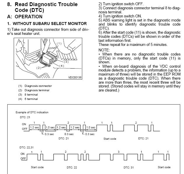

I found an article in the FSM about reading the codes by placing a wire link between 2 pins of a connector. I can load them up if you are keen on reading the codes yourself

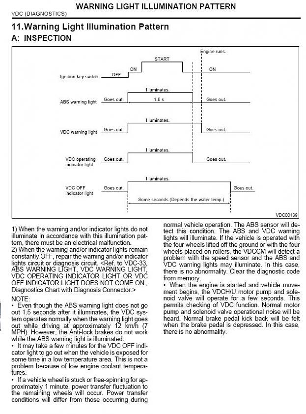

There are 3 VDC lights.
The VDC operation light (picture of car with skid marks) It blinks when skid suppression is activated.
The VDC warning light (just VDC in bold letters) comes on when there is a malfunction in the VDC system.
The VDC off light (VDC OFF in bold letters) It comes on when the VDC OFF button is pressed. It also comes on when the VDC system in deactivated because of a malfunction.
The ABS light comes on when there is a malfunction. The ABS system shuts down under these conditions.
So my guess is that one of the sensors that both the ABS and VDC systems use is playing up.

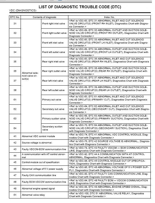

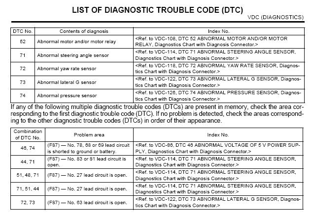

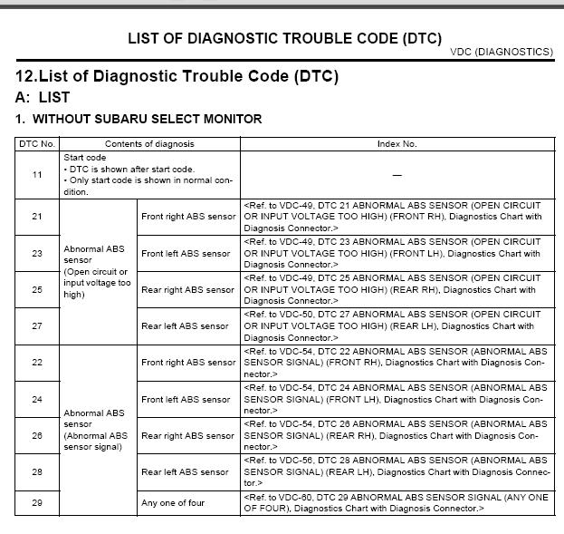

Here are those scans
