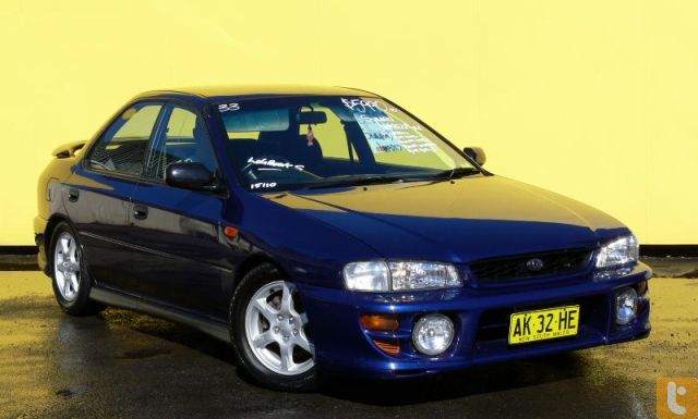

i have put up a pic of a 1999 impreza RX MY99 (AWD) the car im about to buy.. it has a full body kit with BC sports fully adjustable suspension an a 1994cc 2L engine, with 5 spd (man).. is that the ej20 2L engine? becouse if it is! im going to drop the ej20 turbo in her with headers an a lukey exhaust system with a x-force cannon.. tho i dont kno on what headers would be good for this.. any tips pls?

sounds like the ej20

haha okay man back on topic..all model subis are ej20 compatible
a cheap wrx in perth(not sure over east) is worth about 8grand and this will range from a 1995-1998.
If you want to undergo a conversion(the car youre looking at looks like a great candidate for it) youd want to budget for around 3grand id say. This will include gearbox, driveshafts etc. Youll also have to upgrade the brakes, find a turbo bonnet(or upgrade to a front mount)
good thing is if you buy a gc8 impreza and a gc8 wrx frontcut everything will bolt strait up.
id buy a wrx to be honest, saves alot of hassling and you get the real deal.

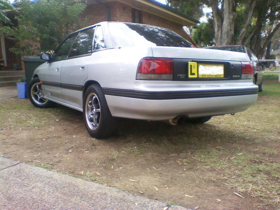

i had to bend them up course the tires 205/50R15's are hard to get for my size 15 rims.. i should of went the size 16 rims with 205/40R16 tires, but too late now.. i wanna lower our liberty, but im scared that the tires will rub on the inside of the inner guards an inner rear wheel arch when i drop the car. the 205 part of the tire looks abit to wide for the liberty an sits just abit inside of the frunt guards an rear wheel archers
