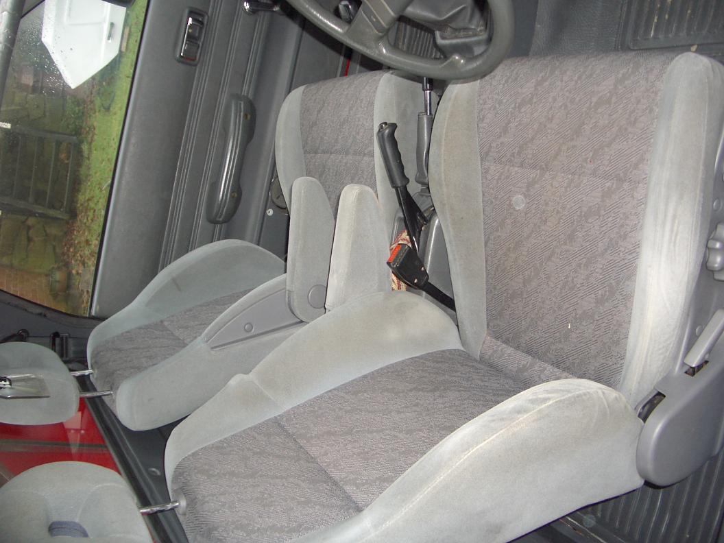

Can somebody please tell me which model/year Liberty the seats below came from:
Are modifications required to fit them to a Brumby?

they are the same as my seats, gen 1 ser 1 liberty!!
Post by RSR 555 » Tue Nov 23, 2010 3:40 pm
Yep.. Gen 1 Series 1 GX Liberty seats.. I prefer the RS Turbo seats in there, as they have the slightly rap around sides :)

Post by phantomD » Wed Nov 24, 2010 3:15 am
Much modding required to put them in?

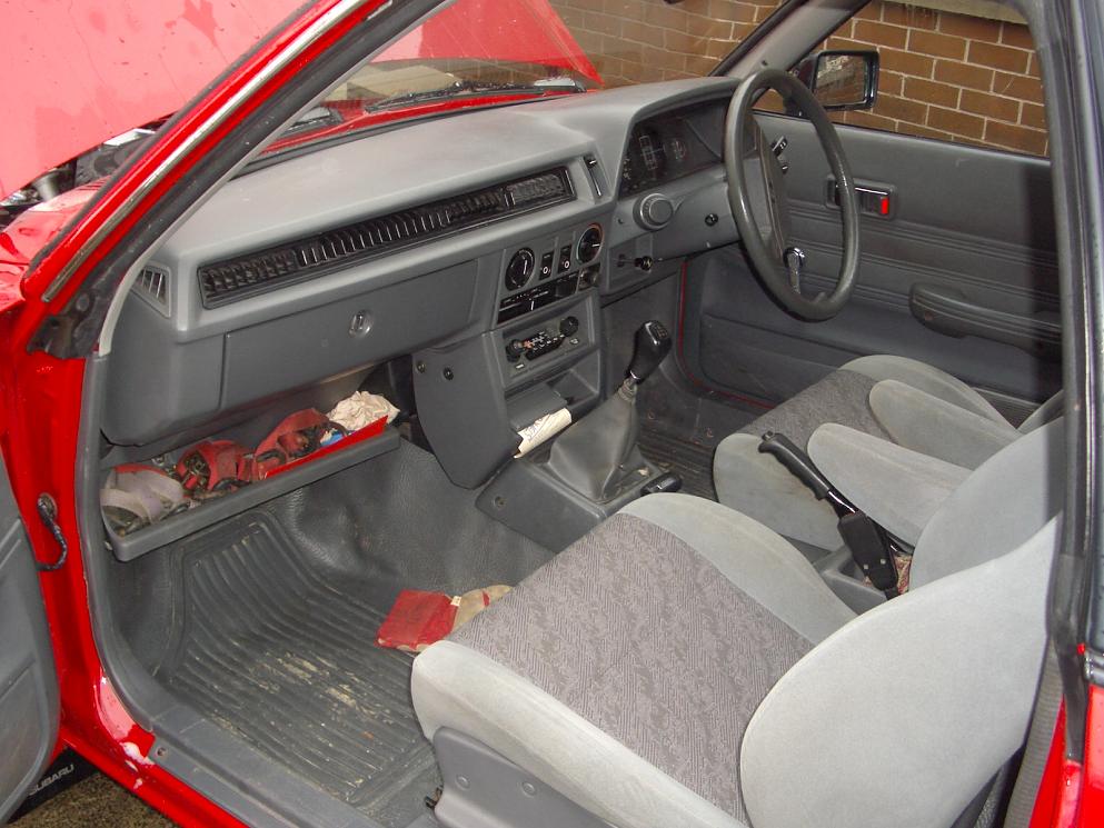

Check out Foz seat too they fit well (with mods to the fixings) get the correct colour and they look factory ! Dinky arm rests are good too :mrgreen:
See image of my set up :D

the rails (the bits that bolt between the seats and the floor! will normally be the bits that have been modified so another set of liberty seats should bolt up if you remove the seats and bolt the old rails onto the new seats!
