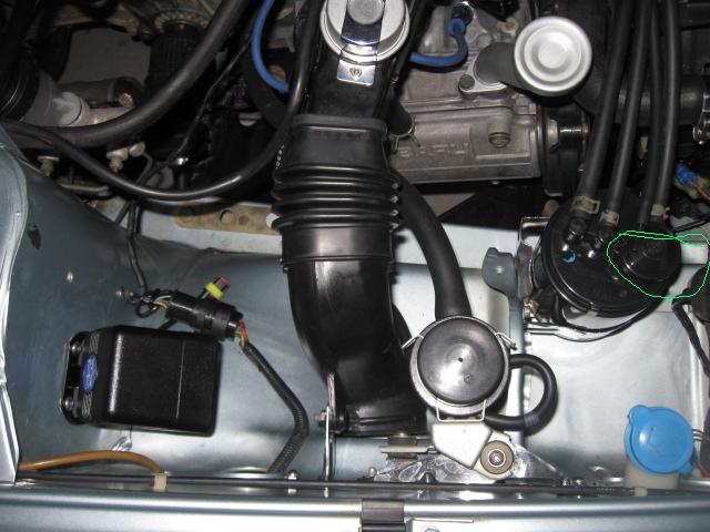

See picture attachd, Remove carbon canister for ease of access on drivers side. On pass side just forward of battery tray, nice n tight. Chassis rails, not behind indicators.

Under the green circle there are two 17mm or maybe 14mm bolts along the rail. Two on each side. This will allow the bumper to come off. You also need to unplug the two indicators that are on the bumper. Its a circular white tube plug.
Did i miss anything?
Also someone must be able to post a better pic of the bolts:)
