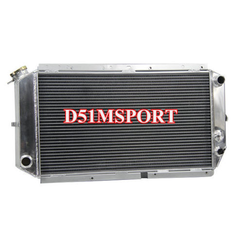

Post by coxy » Mon Jan 04, 2016 9:00 am
You can source full alloy radiators of Ebay in Australia and a brumby one is $159.00 some members in WA I believe may have used the same brand in an L series EJ conversion so some feedback on quality may be available.
Most likely made in China for that price as something like PWR made in Queensland would be more like $600 ~ $1000 but for the money worth a punt I would think.
Just make sure if using Full Aluminium Radiators that all the rubber mountings are A1 and the radiator is fitted with absolutely so stress or it will crack.
http://www.ebay.com.au/itm/GREAT-QUALIT ... SwofxUbavX
