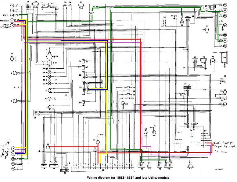

Ok, after a little thought i have some more questions...
I want to have my headlights wired up to the ignition so if i turn the key off - the lights will turn off too. (My old L Series was like this and i don't think i can get used to having to turn the lights off) I am thinking if i run the switched wire from the radio to a SPDT relay and then run the parkers and low beams through the poles this should achieve my aim. Does anyone have objections or a better idea? I did a bit of doodling on the wiring diagram and i think i need to switch the red (RW) and blue(RB) wires. I am planning on cutting into them just as they come out of the headlamp switch in the dash. Good plan??
Next is my aerial is broken. Can i get an aftermarket one at Repco?Is it possible to install an aftermarket one that automatically retracts when you turn it off? Would the Guard have to come off? Thanks...
wiring diagram.jpg (112.3 KiB) Viewed 1637 times
