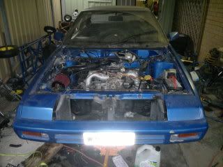

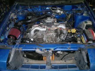

then home to install the intake and some piping

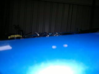

and thisis why the bonnet needs spacing, or crossmember dropped

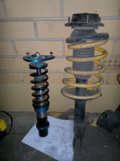

this is a forester strut with raised spring next to my future strut

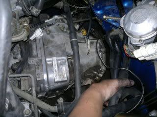

oh and this is what i did so i can start it while waiting on a manual, just the front of a autobox
