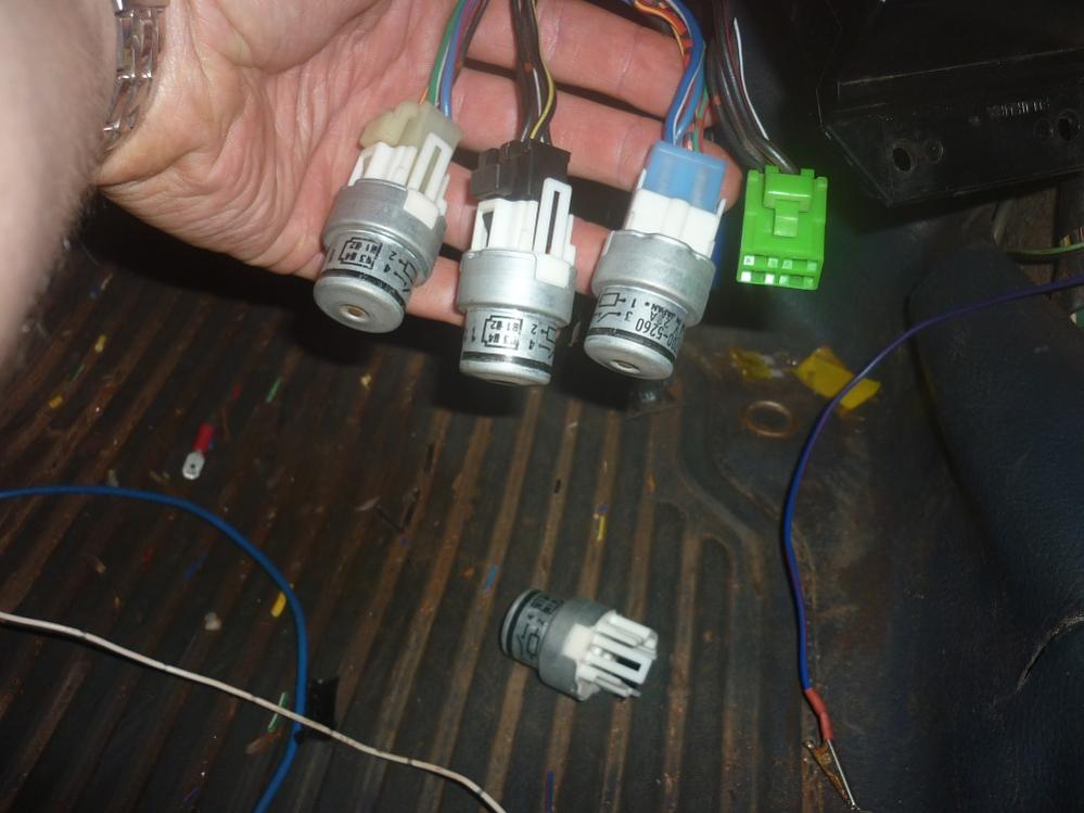

started putting her back together, theres a few connectors where i cant find their other half, and unsure on the 3 main ones underneath the drivers side dash. theres 3x4 pin connectors. black blue and white. and underneath the dash theres 3x4pin outlets. but not colour coded. wish i labelled/took a mental photograph now lol.

Post by El_Freddo » Mon Jan 16, 2012 8:38 pm
indy wrote:also with the hot/cold on the heater box. is there only one adjustment cable that goes to it?
Only one cable.
As for the plugs your'e confused with - you'll find a set that are wired together (from memory), these are the AC plugs that intercept the fan controls, I think. Anyway, you need these plugs to connect with the others otherwise you're AC won't work. You might have to trace some wires... fun fun!

Post by GOD » Mon Jan 16, 2012 9:27 pm
I reckon those plugs might be for the relays tucked up somewhere above the fuse panel. The relays (four on my car, maybe only three on yours) are all the same, so just plug any one of your mystery connectors into each of them.
In my experience, only the plugs that are meant to go together will go together.

Post by indy » Tue Jan 17, 2012 3:31 pm
Yep that's the one thanks heaps god! Just a couple of random connectors to go and the steering column the 2 little 10mm bolts down. near the base of the column I can't seem to line up with the holes, the shaft seems to need to go down a few mm
