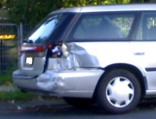

Hi everyone,:)
I asked for help here a month ago when my 97 Subaru Liberty was smashed by a truck. I would like to thank you all for your opinion earlier! but I need more:eek:
Please take a look
[ATTACH]3196[/ATTACH]
[ATTACH]3197[/ATTACH]
The driver at fault agreed to pay me $2000 (waiting for his cheque now) and I found a smash repair who will replace the rear quarter panel, bumper and light for that amount.
Since the $2000 quote is much cheaper than the quotes I got from four other smash repairs ($ 3000 - 5000), I am worried if their service is reliable. I know I am being a skeptic, but please forgive me:o
:confused:My first questions is, how do I know if they are licensed or not? I got the smash repair's business card and I could find them on google map, yellow pages, star locals, etc. Does that mean something?
:confused:2nd question is, will safety or mechanical function be compromised even if I get my car fixed? will it be it better to fork out another $2000 and buy another car?

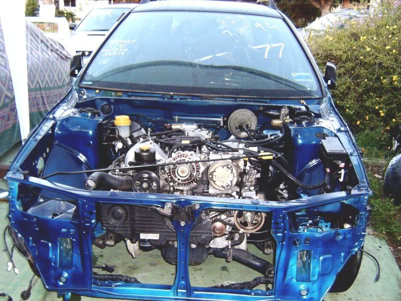

You could cut that whole corner off the car and structurally it really wouldn't make any difference so what you really need to look out for is cosmetics, personally I'd be looking for someone wrecking one and buy the light, bumper and pretty much anything else you can find cheap, even the whole quarter panel..... cut the whole thing off right up to the back wheel at the bottom of the door and above window level with a 9" angle grinder then let the panel beater unpick whatever he needs off it, I've done this quite a few times and saved thousands, you can even find mobile panel beaters if you can supply the parts, I had the whole front off an Impreza I bought which I paid $50 for by a mobile guy for $1,200.

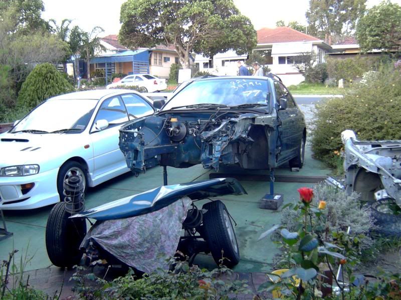

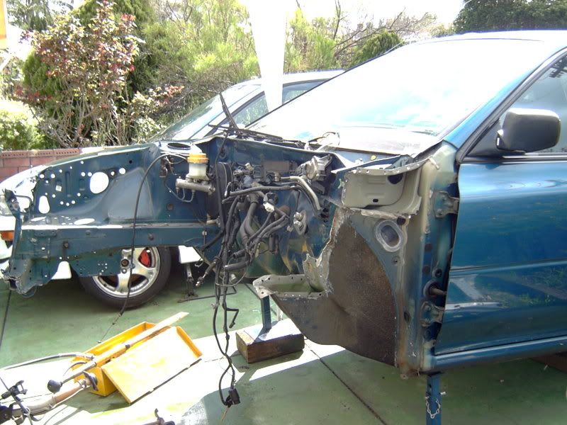

Examples, admittedly I did a lot of work myself by stripping the cars, painting etc but I also made quite a profit on them.
Looks worse than it was.
The old rear quarter which was left over from the blue WRX in my sig put to use.....It was a red car originally.
End result, funnily enough both these hatches ended up back at pickles where I originally bought them from lol

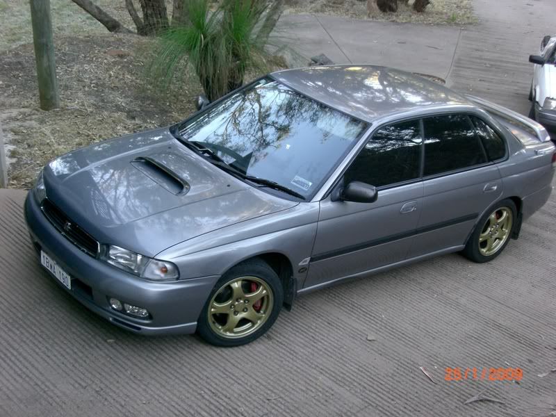

My daily driver which I've had for over 6yrs as I bought it.
Years later.

that looks like a pretty big hit. Is the tail gate opening untouched ? If no then that might be why the other quotes were so high - they included the work to straighten it properly - and the last quote might just be straight panel replacement and hope the opening is straight enough or bodge the gaps.
Is it AWD ? might be better keeping the $2k, parting out the wreck and buying another car if it is AWD.

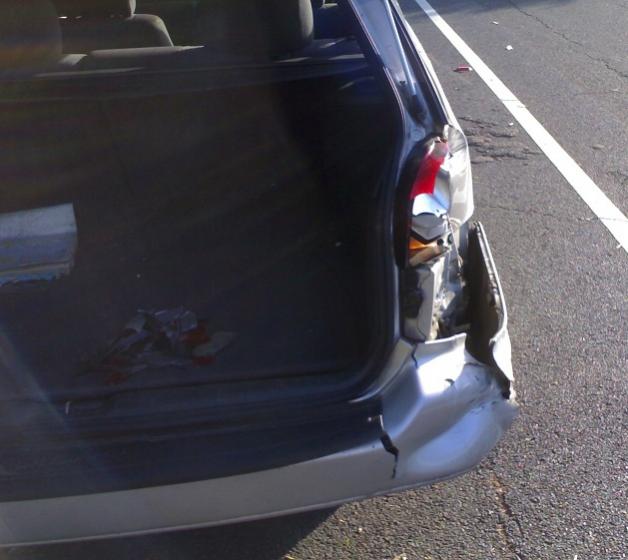

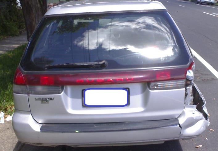

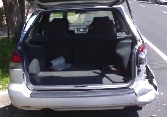

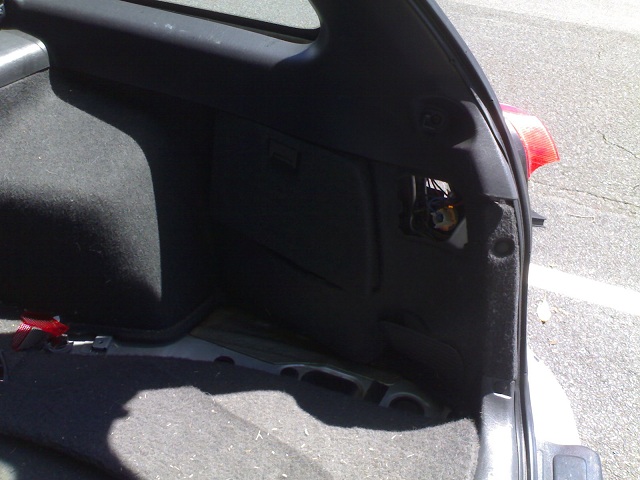

I am an amateur and really have no idea if the tailgate opening is intact:confused: None of the smash repairs I consulted had talked about repairing the tailgate
I took 3 more pics, could you please give me a clue?
[ATTACH]3198[/ATTACH]
[ATTACH]3199[/ATTACH]
[ATTACH]3200[/ATTACH]
The car is a 2WD which has 250k kms. :(
I bought it 2 years ago for $5000 when it had 240k kms. I do not drive much and my plan was that it will run for at least 4 years til I finish my study...
The only major component that has been replaced is one of the control arms.
I would prefer to fix the car if it can run safely for at least 2 more years, if not then I will have no choice but take another $2000 out of my pocket to buy another car...:(

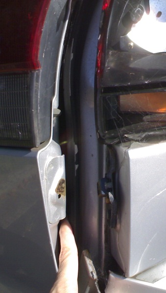

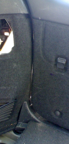

Based on the damage on the car, do you think the $2000 quote is unreasonably cheap for a licensed smash repair in Sydney?
Unfortunately, there is a little gap between the door and the tailgate opening through which I can barely put a finger in:(...
The door looks to be in its exact position, I guess there is a slight deformation of the opening. Is this a BIG deal?

was it a hit from the rear or a front to rear side swipe. if its from the rear could have pushed it forward that little bit run a tape down the sides to find out. its not out by much

You have to realise that once the outer guard is cut off they can easily adjust any minor damage on the inner panel with the tap of a hammer as it's only a thin piece of metal so I honestly wouldn't be worried, when they put the new outer quarter back on they will get all the welds to line up with the inner so it will be fine...........I think you are worrying too much, just ask what and how he is going to do it and ask to have a look around at his other work in the workshop. Good luck

I was parking on the left side of a one-way road and it seemed the at fault driver hit my rear right side with his front left side:o
I will try to find out if the opening was pushed forward. Anyway, I am happy to know that the gap is not a big deal!:D
