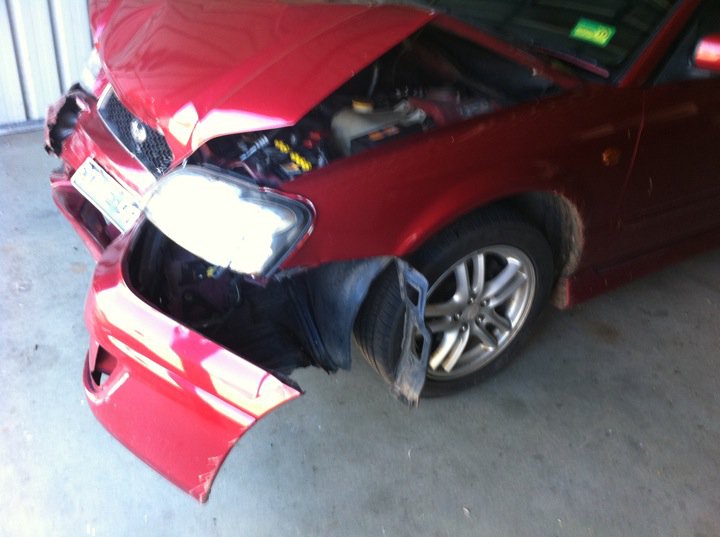

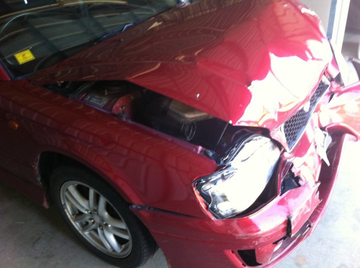

Recently joined your forum and have a question (or 2) already. My daughter rearended a Tarago (am I allowed to say that here ;)) in her MY03 Liberty a little while ago. The crash did bend the front chassis rail, but did not set off the airbag.
I was looking on evilbay (amongst other places) for parts/wrecker to see if it was worth fixing. I found 2 others (Impreza and Outback) that had fairly substantial hits up the rear and in photos of the interior, no airbags were set off either. A 4th Liberty at the wreckers also had a big hit in the front and again, no airbag deployed.
My question(s) are, should the airbag/s have gone off and 2, if so has this happened to anyone else? and should I be asking "Subaru" itself some questions.

Looks like a decent hit from the pics but no the airbags shouldn't of gone off. From where they are there isn't any damage.
There are only 2 airbag sensors on any Subie with front and passenger airbags (only 2). They are infront of oth front wheels in the fender guards attached to the chassis.
In the first pic I can just see one which is yellow where the bumper has been pushed forward.
If they haven't been damaged then they won't deploy. Luckily the car is wuite easily repairable.

As stated above, the damage does not look severe enough to have to have damaged the sensors. Im pretty sure they are located at the front of the chassis rails, where the chassis rail meets the radiator support panel.
