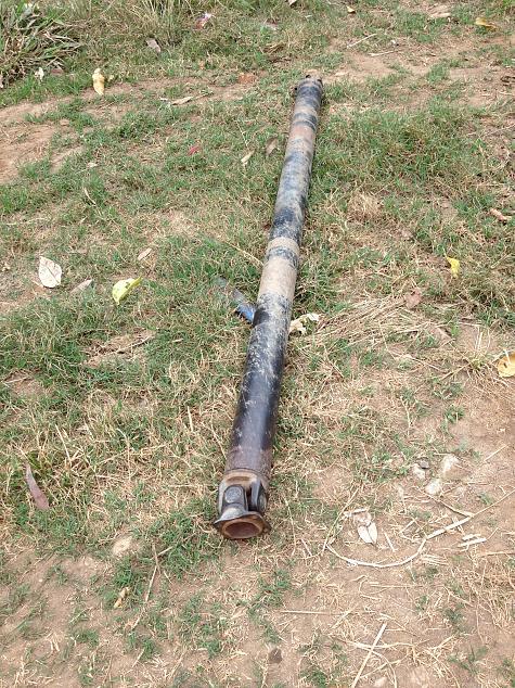

has any one heard or seen of an factory L series wagon with a single piece tail shaft, my unis went and i spoke to the subi wreckers here and he told me i was on drugs because he has been wreaking them for 25 years and never seen em, its not custom because it doesn't have the bolt up mounts for the centre bearing and never has, i had to take it to him to show because he didn't be leave me... my thoughts are it might be an import or something. mabi someone has some answers :)
thanks mitch
Post by Gannon » Wed Aug 22, 2012 10:27 pm
What year model is it?
Have you got a photo of this driveshaft?
Earlier MY models had a one piece shaft, but I'm pretty sure they had a shorter wheel base and a longer gearbox so the shafts arent interchangable.

I don't think the wrecker is talking about an L series - I reckon he's thinking MY... Or it's not a factory shaft if it's a one piece in the L series.
I'm sure there have been members on here that have had the uni joints "converted" to replaceable units on the L series two piece shaft.
I'm keen to see a pic of your tail shaft if it is a one piece ;)

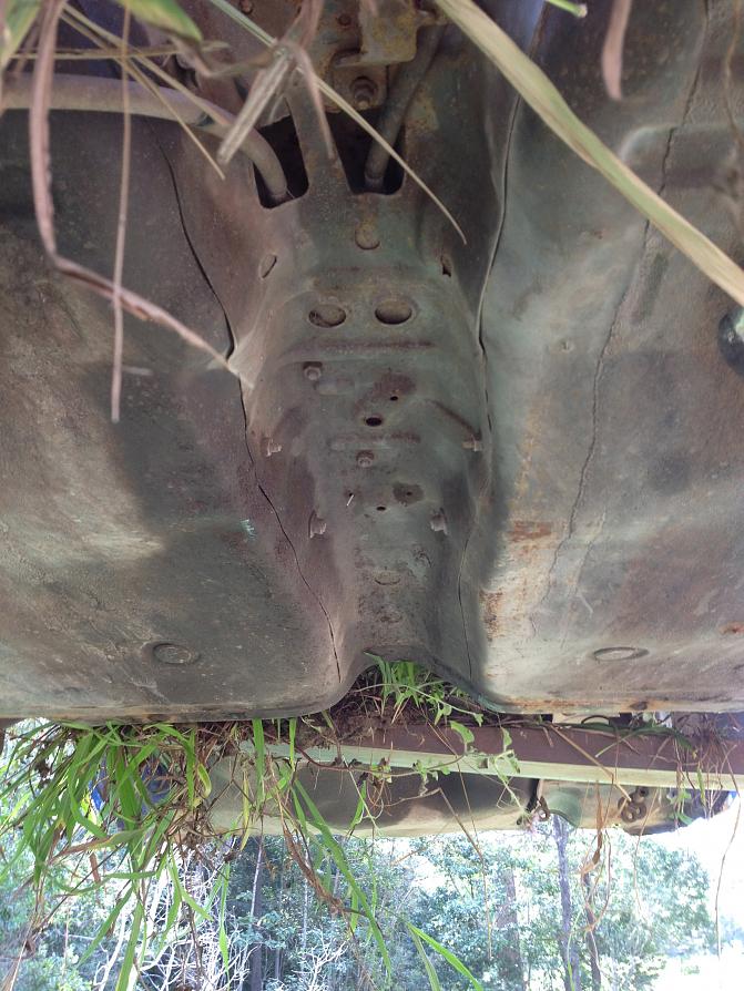

yea i thought that too but there is no mount points on the under body tunnel like there is in every other l series, the my wagon is the same as a brumbry and that have a shorter wheel base than an l series, its the blue one in the pic, but i have the striped body at work ill lift it up with the fork lift tomorrow and take a pic of where u cant bolt a centre piece bearing from a 2 piece shaft...this car was original with a single piece, just no one has ever heard of it. personaly i prefer the single..

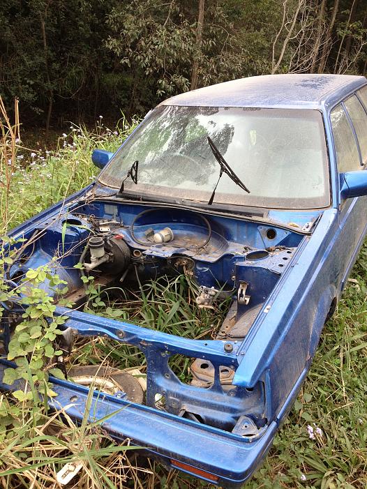

yes he said they all do, even the front wheel drive sedans.. he has never seen a L with out mount points... here are some pics, i guess its just a little bit special.. :)
Post by steptoe » Sat Aug 25, 2012 8:14 am
I think a bit more than your unis have gone in the three pics ! I take it you started with the painted shell in the scrub then ended up parked next to the Volvo?

I have had one customer with an 1988 L.Series wagon that looked like a Touring Wagon but without the high roof. It had all the electrics and and plush trim but it was 2WD only. The owner asked me if I could convert to 4WD and he's me thinking 'hey.. it's just another L.Series, so hard can it be?' Well, I got it up on the hoist and you wouldn't believe it.. it had no centre bearing mounts for the tailshaft and no mounting holes for the rear mustache bar. I went and brought 'riv-nuts' for the rear and made a 1 piece tailshaft.

haha no it started a light blue and because I'm a painter i had to paint it, then my chassis was so rusted from to many beach trips the lower control arm went through the floor and i took those photos the other day sitting in the scrub, bit sad to see it there now like that after all the effort building it but i have my new 91 wagon now..
