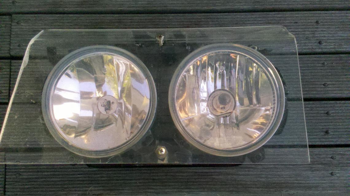

I made up frames and covers to fit dual 4inch headlights.
I have used Narva "standards approved" headlights and they were better than standard lights. More range, but limited spread.
I gues I will continue down the path of dual 4 inch.

I meant 5 3/4 headlights.
I was looking at 4 inch HIDs, but the legalities and look were to hard.
I will continue with the Narva's as they are the best so far.
Just got to paint the back of the cover and make up some tubes to fill the gap between the lights and the cover.
[ATTACH]3725[/ATTACH]
- 2012-12-10_19-44-23_527.jpg (112.27 KiB) Viewed 4631 times

I went for long walk around centre road wreckers looking at dual headlight frames. The main problem was they were mostly on bigger cars, so they were spaced far appart. They also had stepped or complicated rad support panel mounts.
The corona ones were flat mount, close together and I was sick of walking, the three main reasons I chose them. (sorry Bennie, they were the only set)
Welded some mounts, bent out of 20 x 3 flat with 6mm bolts welded on the ends, to fit straight into existing mounting holes.
A few other "customisations" and bent up some perspex offcuts.
Got the lights, second hand, still in boxes, never used, on ebay.
Never seen these Narva lights listed anywhere.
Will finish it off soon, but the A/C has suddenly become more important.
