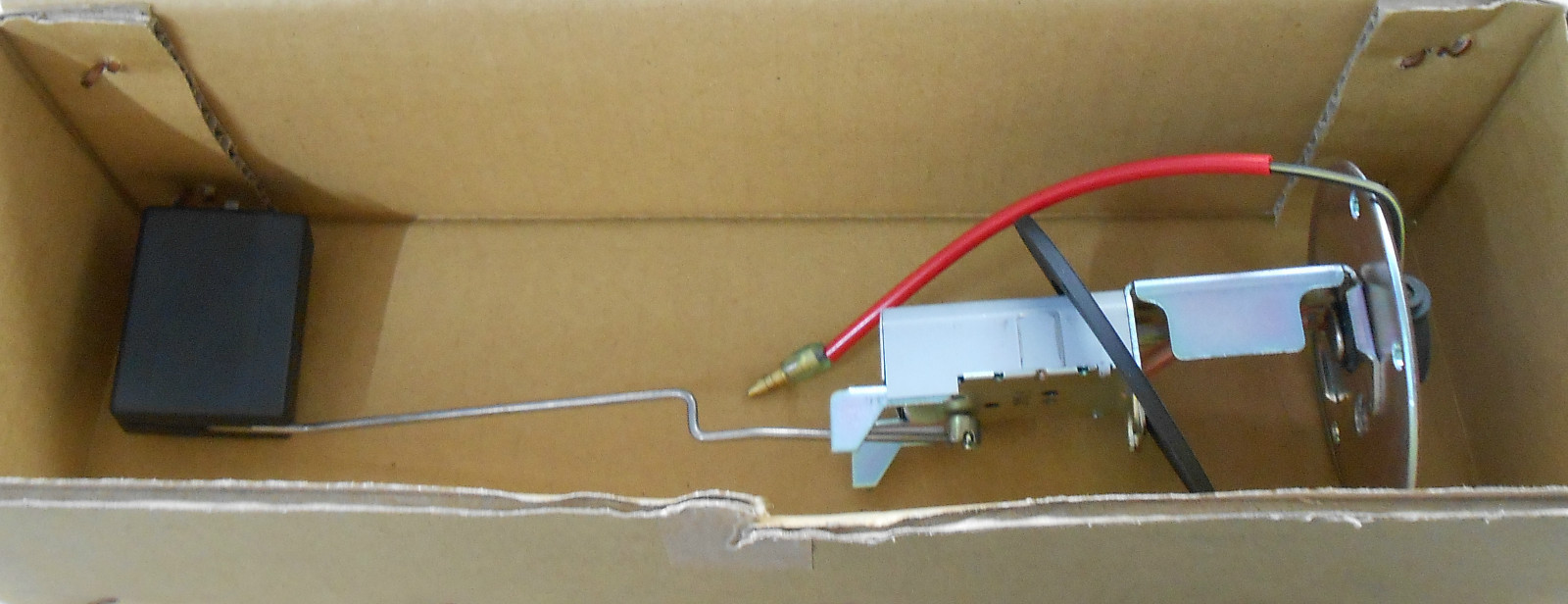

Found this on ebay :
Part No: 785111080 via this link : http://www.ebay.com.au/itm/GENUINE-Suba ... 19f0d8dfae
Now we just have find an Auto ...
Cheers, Bantum ...
Cheers, Bantum ...
