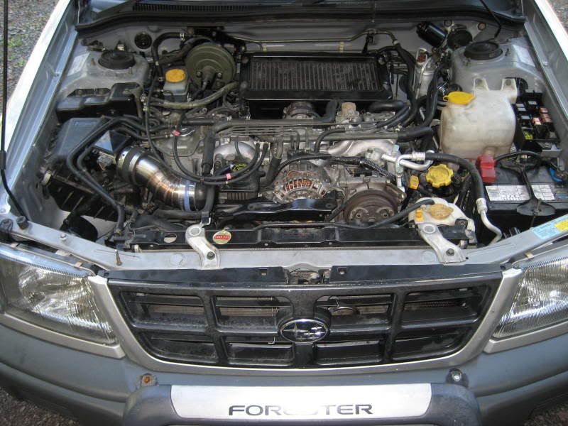

Not an easy fix but effective.
Cheer. Al.

Excellent post!
Very effective mod, I have done similar to other cars and can also vouch for the effectiveness.

Oh yeah, it is a BG5A TT Auto drivetrain and the bonnet scoop is coming.
Not mine either, just wired it up.
Cheer. Al.

what year TT is that?
how hard would you rate the wiring job on Al's scale of difficulty
spliced into the front loom or replaced teh front loom with the TT one?
very cool conversion

It a 96 according to the select monitor.
The wiring is spliced, harness swaps are impractical IMO.
It is reasonably involved to rewire, mainly because of the way early TT's wiring is layed out(the harness goes out through all 4 wiring exit points and is 2 piece where it goes out into the drivers guard) and secondly because it is an auto with a seperate auto computer that also needs to be wired in.
It just takes time to pick your way through it. Took me ~2days including all the dash work and some mechanical stuff(timing belt was out 3 teeth).
I have all the relevant text and have done it many times though.
I think you need a TT in your wagon Vv.
Cheer. Al.
