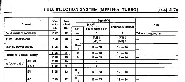

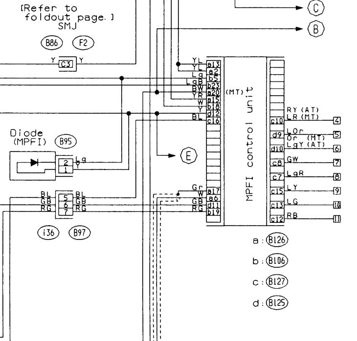

Make that 100% certain. B126 (a) Pin 20.
Shown as always connected in the engine wiring diagram, which has both auto and manual wiring on it, but I've found my fair share of errors in the FSM diagrams.
Slide that pin out of your ECU plug, and you should have a manual EJ22 ECU :D
