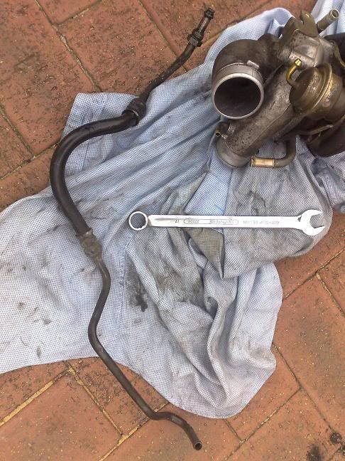

i need one of these fairly urgently.
mine was resting on the turbo and i didnt realise! bastard of a thing!
it the top one which goes into the power steering rack.(its only threaded on the end that goes into the rack)
thanks heaps!

Pretty sure Enzed are open tomorrow, bring the hose to them, it's probably a 10 minute job :)

I got all mine replaced with steel braded lines from Enzed. Can't remember how much it was but it wasn't cheap. Worth it if your keeping the car.

got one from the wreckers this monirng. thanks anyway guys...

thats only a return line. so if u get stuck anther time
just cut the bottom off tighten it on the rack and then use Transmission cooler Rubber hose to go up to the pump anyway you want.
