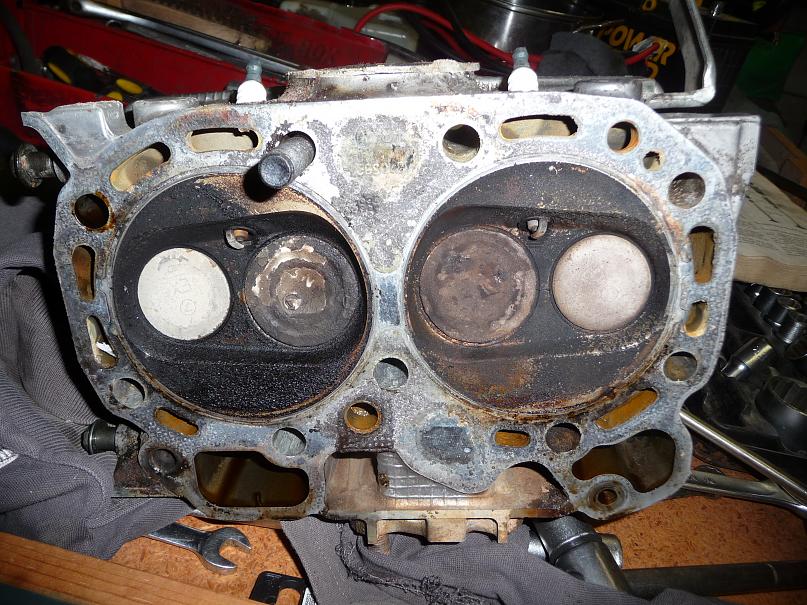

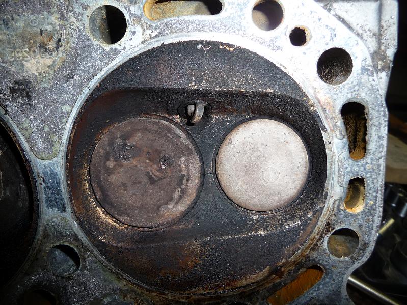

hi everyone,
I bought a 91 GL for cheap the owner said that said it was overheating and using water.
He had it tested and found it was loosing compression on cylinder 3 (driver side rear) he believed it was a head gasket.
I have pulled it apart and found a crack between the valves on the head in cylinder 3.
When I drove the car it did not get THAT hot in my opinion (half way on guage with heater on).
My questions for the forum
[INDENT]
Could this crack be causing the lack of compression?
Could the head [quote][/QUOTE]be fixed or will I need a new head?
If I were to just run the engine with the crack would it get worse/how long would it last?[/INDENT]
thanks in advance.
-Ben

A crach between the valves aint a big deal, nearly all EA82 heads have cracks between the valves.
Were you loosing coolant out the exhaust pipe?

Take the head into a engine reconditioner and have it pressure and vacume tested. If it passes, it is fine to use, if it fails need to find a replacement. Cracks are typical and aren't an issue unless the crack is severe enough to cause cooland loss, over heating, compression in cooling system...ect. What does the bore and piston look like on cylinder 3. Check if it looks like coolant has been burning there

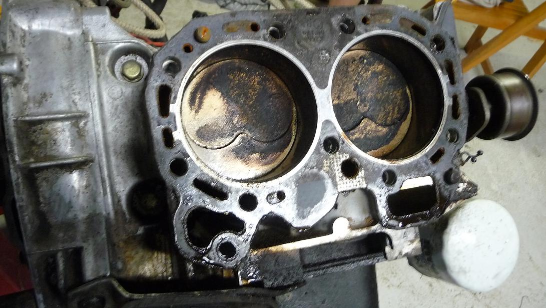

to be honest i only drove it for one day and didnt check, I had a look at the exhaust pipe gasket and inside. it was black and sooty (obviously) but seemed quite dry and powdery. In my oponion there hasnt been coolant in there.Suparoo wrote:A crach between the valves aint a big deal, nearly all EA82 heads have cracks between the valves.
Is it common for Ea82's to leak coolant into the exhaust and if so where does the leak usually form? I will check it out
Thanks
funnily enough cylinder 3 was the cleanest of them alljustincase41 wrote:Take the head into a engine reconditioner and have it pressure and vacume tested. If it passes, it is fine to use, if it fails need to find a replacement. Cracks are typical and aren't an issue unless the crack is severe enough to cause cooland loss, over heating, compression in cooling system...ect. What does the bore and piston look like on cylinder 3. Check if it looks like coolant has been burning there
Im gonna take it in for check tomorrow
thanks for help

As mentioned earlier, I'd get the heads pressure checked and go from there but looking at your first 2 pictures, I'd say the engine was losing compression near the water jacket on #3 down near the bottom and this would cause over pressuring in the water system in which you would lose coolant. In the case of a good sealing head gasket, the clear ring around the combustion chamber should be the same all the way around. You can also see signs of water entering the combustion chamber (you'll notice that #1 looks blacker from carbon build up).
I have use many cylinder heads on EA82 engines that have had the same size cracks as yours but I'd still have them tested. It's small insurance to pay when paying for a engine build.
If your bores look good then all you'll need to buy is a Valve Regrind Kit (gives you everything from Head Gaskets outwards) and make sure you get the radiator flush out.
Good luck and let us know how it all turns out

1991 GL would be carbied. MPFI heads are significantly different aren't they?Bennyg wrote:hi everyone,
Dane.
Ohhhh Yeaaahhhh!GOD wrote: MPFI heads are significantly different aren't they?
MPFI heads have dual inlet ports and arent compatible with the carby intake.
I cant see why you cant refit the current heads, as it looks like you only blew a head gasket
