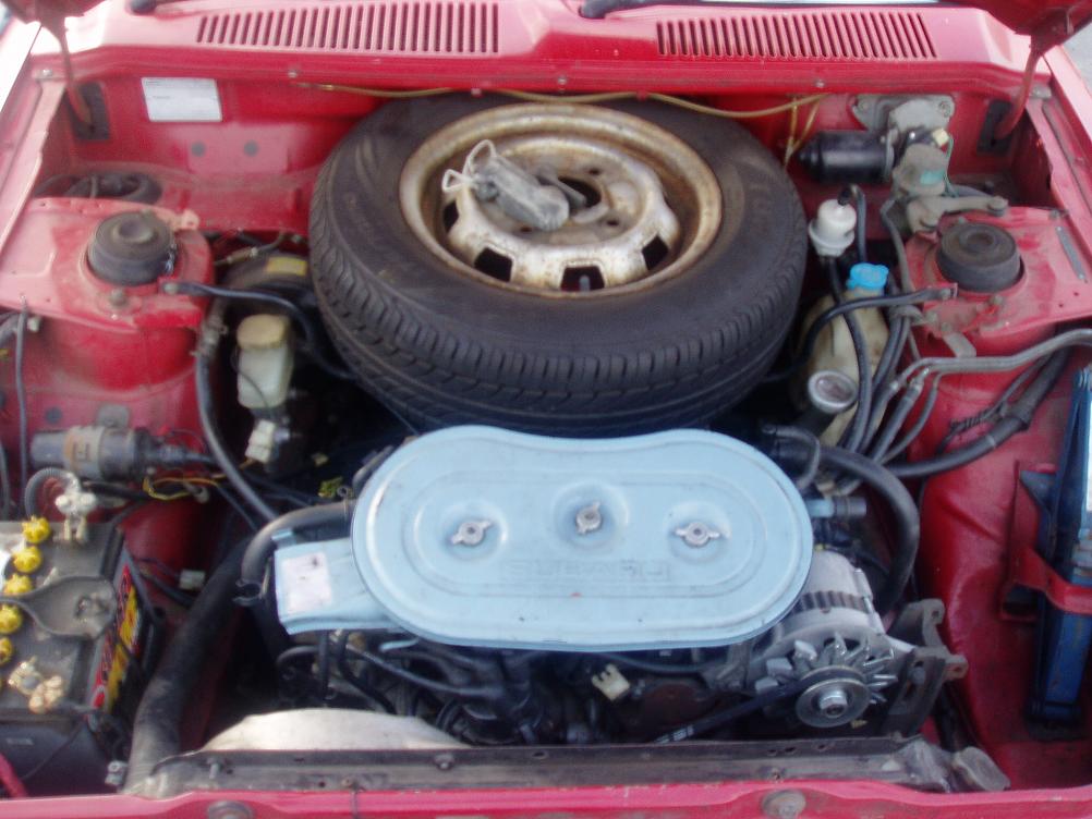

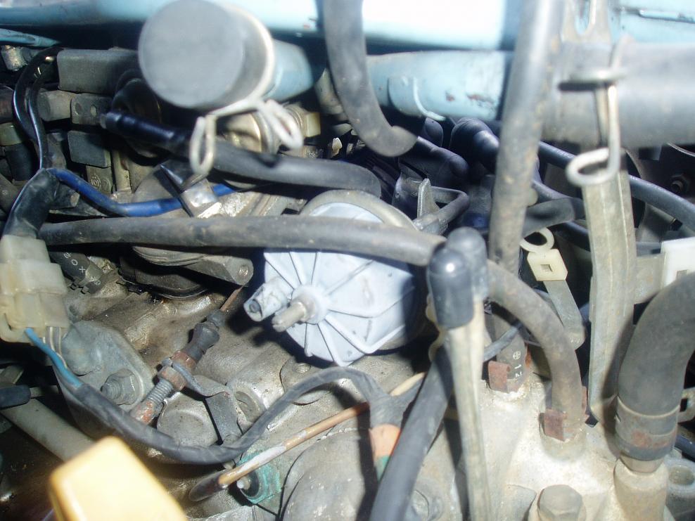

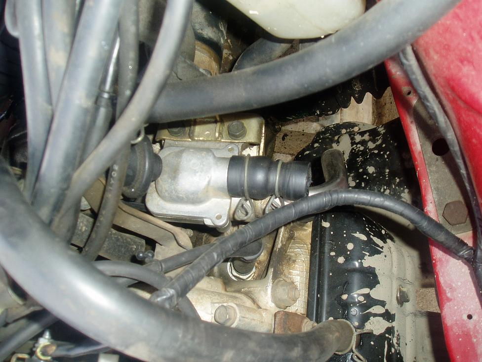

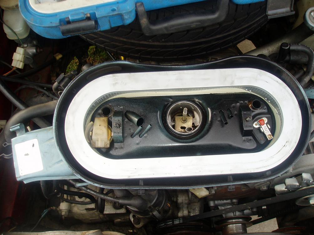

Ok. Just been out to look at the old girl and got some photo's below. All looks fairly normal right? Well the end of the air inlet is swan off (+10hp there!) and a couple of vacuum hoses not connected and are blocked off.
In the photo that shows inside the filter housing, the thing that's on the far left is not connected. Is this important? It appears the carby has been off at some fairly recent stage.
Bugger me I hope it's not carby, I hate working on those things. Give me Diesel and Hydraulics anyday.
But all looks good. The Rotor cap is a bit rough, but shouldn't cause a intermittent fault.
Fuel filters are new. Another one I found while googling, was faulty (cutting out) fuel pump. That, to me at least doesn't sound like it though. Especially since when I put the foot down, mid cough, she revs clean.

it could just be a niggly little pollution hose on or near, to or from the carby. Light cruise throttle sounds like the EGR function time. Maybe see if it is getting its vacuum supply. Try what I have done T in a new vac line to incabin to a spare EGR valve to feel when it works little finger poked inside it. See if that is when your problem is, or try block off EGR on manifold totally, likely to be all carboned up in 21 years. You just bought it ? A good bit of advice is go buy and fit a full tune up. Dizzy cap, rotor leads plugs air oil and fuel filters there is two on a brumby. Subaru sell an intake cleaner in a pressure can for about $17 . It is , or half is sprayed into an intake manifold hose to let it expand and clean internally on a hot engine, run and see all the crap blow out the tail pipe. Comp test and tappet clearances a good check too - being a Diesel dude you'll appreciate that
