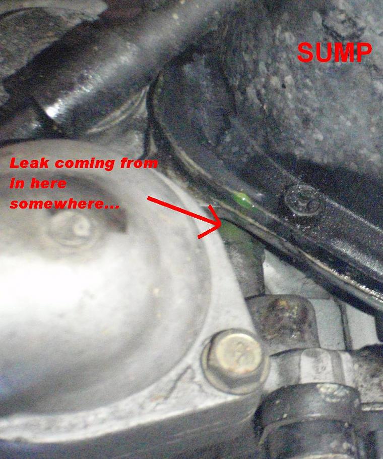

Hi,
I've recently had coolant dripping at about 1 drip/sec when the car is running, a bit faster when its hot.
Looks like its dripping down from the centre of the engine, slightly the passenger side of the car. dribbles from somewhere unseen and then drips onto sump housing...
Could this have also started an oil leak? noticed lots of oil coming from same side head.
please see attatched photo of where its dripping from...
What do you think of it?
Thanks,
Tim

Hi and Welcome Tim
Sounds like the water pump tell tale
time to replace the pump.. and maybe the timing belt and pulleys while you're there
yep definitely the water pump. Must be the seal that's got too old.
rocker cover seals (or cam covers) for the oil leak...fairly common in the older motors.
yeah id say water pump, could even just be a split hose in that vicinity also.

3+ Water Pump.

Mate Don't bother getting 2nd hand one or reco pump, just get new one for monies worth.

That pic will be a dead water pump for sure. I checked the one out on my EJ22 before installing it in my L, all checked out well until I did a ~100km drive to bendigo where she started dropping coolant. Turned out there was quite a bit of shaft play that I didn't check.
