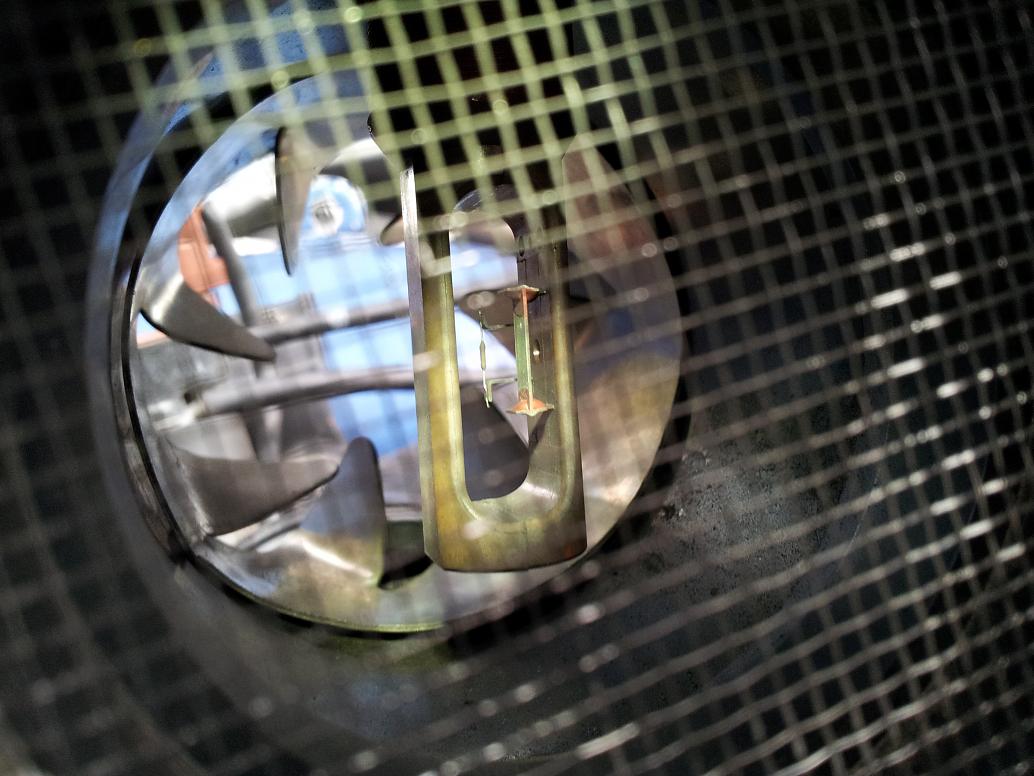

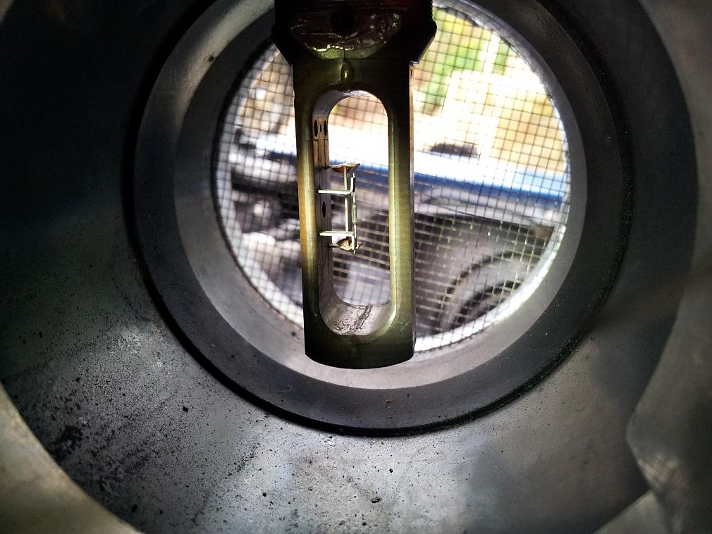

Edit: I just opened up my air filter and took a couple photos of the MAF sensor. Does it look like it needs cleaning?

I don't think so mate. All that MAF sensor consists of is that small bit of wire in the middle. The ECU drives current into it to heat it up to a specific temp. As air flows past it cools down, so the ecu supplys more power to maintain the temp. The airflow into the motor is proportional to the current the ecu drives it at. No moving parts to gum up ;).
Doug
Post by Gannon » Sun Jun 09, 2013 5:53 pm
Subydoug wrote:No moving parts to gum up.
Yes but no.
If the sensor wire gets coated in oil and grime it becomes less responsive because the grime acts as (thermal)insulation and prevents it from measuring the true temperature/current relationship. Over oiled K&N filters are known for causing this
As for the air flow meter in question, it looks quite good.
Looking inside your MAF, your air filter doesn't do a very good job.

littlewhiteute wrote:Looking inside your MAF, your air filter doesn't do a very good job.
What air filter are you running?

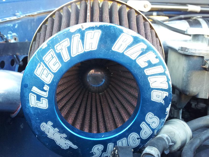

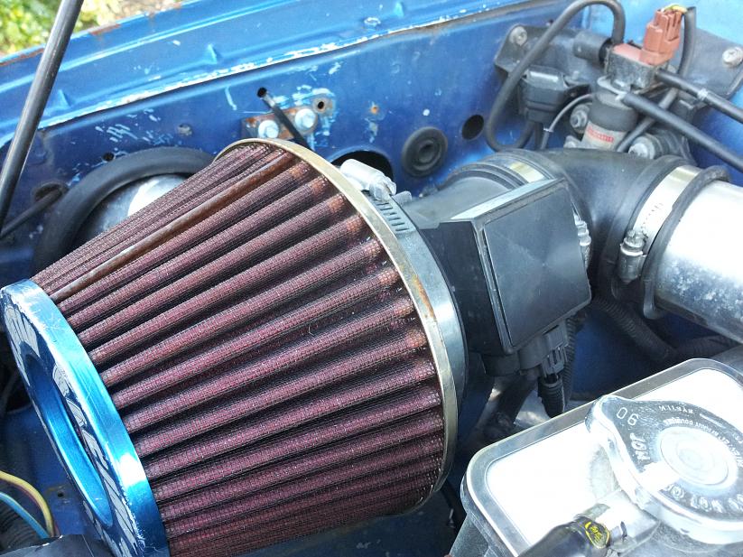

A pod filter of some sort. It seems pretty dirty looking with the brown colour. I will take a photo of it tomorrow and try and find a brand on it.

Is that a hiclone or something I see in the second pic? Or are those fins something stock?
+1
remove the MAF and clean it with Electrical contact cleaner, then throw away your old air cleaner and get a new one.
Preferably something with a dry reusable filter.

Alex wrote:Is that a hiclone or something I see in the second pic? Or are those fins something stock?
I checked Google Images and Hiclone has fins that meet in the center. I don't think my ones are stock however.

Here are a couple photos of it. On the front it says "Cheetah Racing Sports" which I assume is extremely rare because I can't find any on Google :)
