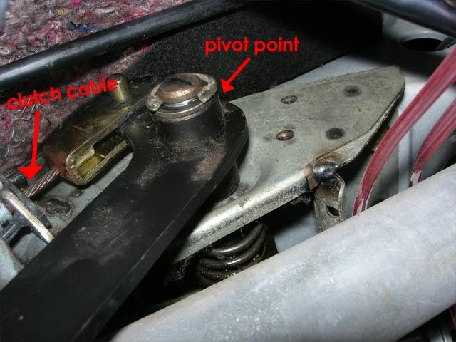

basically the pedal suddenly went soft and eventually the clutch could not even be disengaged with the pedal because the cable wasn't pulling the bracket that disengages the clutch back far enough to work. I tried to re adjust the cable at the gearbox side but there was no more thread for adjusting.
As a result of stepping on the clutch pedal in and out repeatedly to try and figure out what went wrong, I heard a crack sound (like something had broken or popped off) and the pedal now does not spring back to position.
pics to explain:
clutch pedal after
clutch pedal at the pedal box assembly under the dash

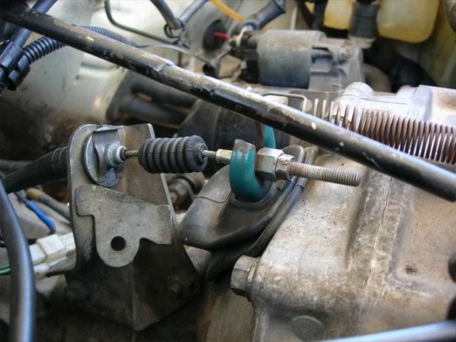

This is how the end of the cable at the gearbox side sits when the clutch pedal is at normal position:
This is how the afore-mentioned assembly sits when I push the pedal in:
^^ as you can see, even with the pedal pushed in, the other end of the cable isn't even pulling back far enough to pull that teal coloured bracket back to disengage the clutch.
I don't think the clutch cable has snapped because there is movement of the pedal when I pull and push this end ^^^ of the cable.
