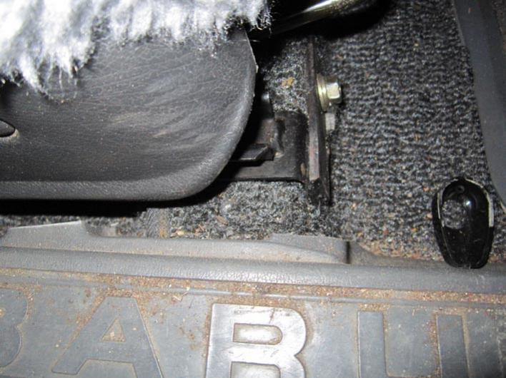

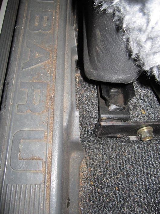

Post by Brumby Kid » Wed Feb 08, 2012 7:10 am
Tozzy,
That is a perfect pic, exactly what I needed!!!

Post by Tozzy » Wed Feb 08, 2012 10:59 pm
Photos of the cut away parts of the side step kick panel.
Cut Side Panel 1.jpg (64.87 KiB) Viewed 2098 times
Cut Side Panel.jpg (76.25 KiB) Viewed 2101 times
