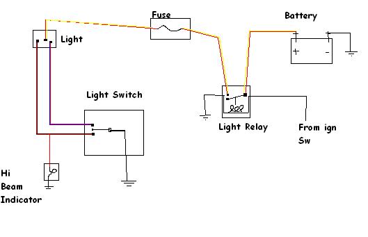

Here is a very rough sketch of how your lights are wired
Have you got 12v at all light terminals when the both globes are in? or when they are out?
I think the problem is in-between the globes and the switch, or the switch and ground

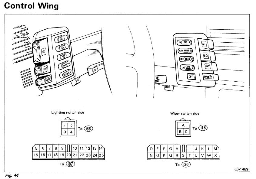

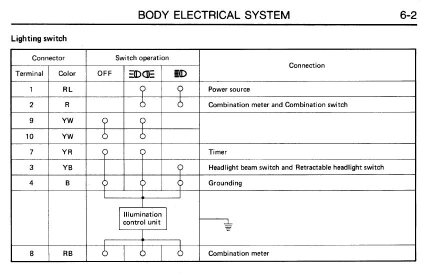

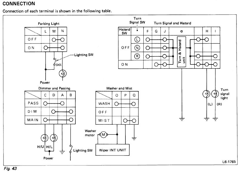

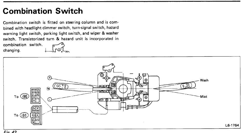

Here are some diagrams i have dug up.
Now if you turn the ignition on, and disconnect plug i90, on the car side, you should have 12v at terminals C and D. This means the wiring from the headlights is intact. Plug it back in.
Now unplug i86 and on the car side you should have 12v on pin 4.
Post your results and we'll go from there
