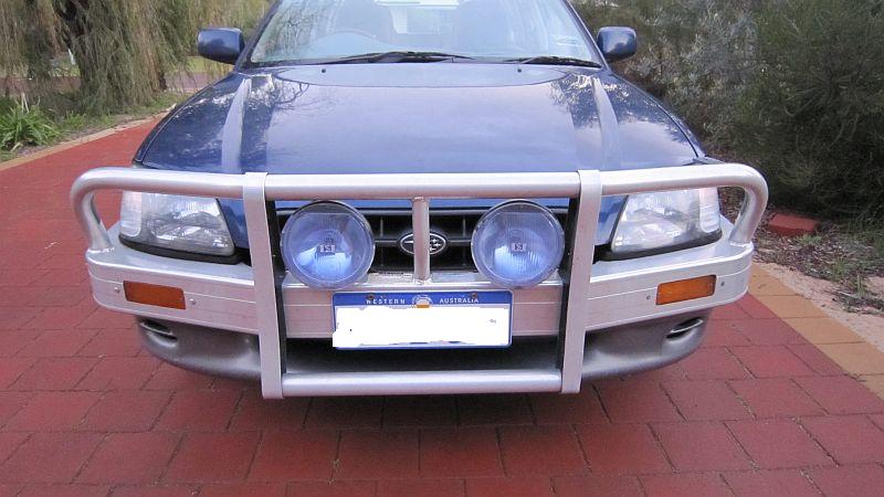

G'day, I've got an Irvin make of bull bar on my Outback and it's air bag compatible, here's the link.

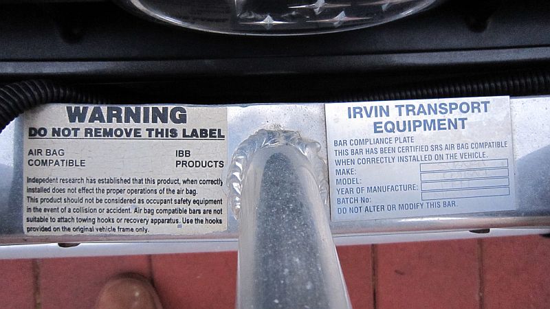

Post by dale147 » Mon Jul 12, 2010 7:41 pm
Here's my bull bar, it's hit 2 roos so far and has been ok each time
