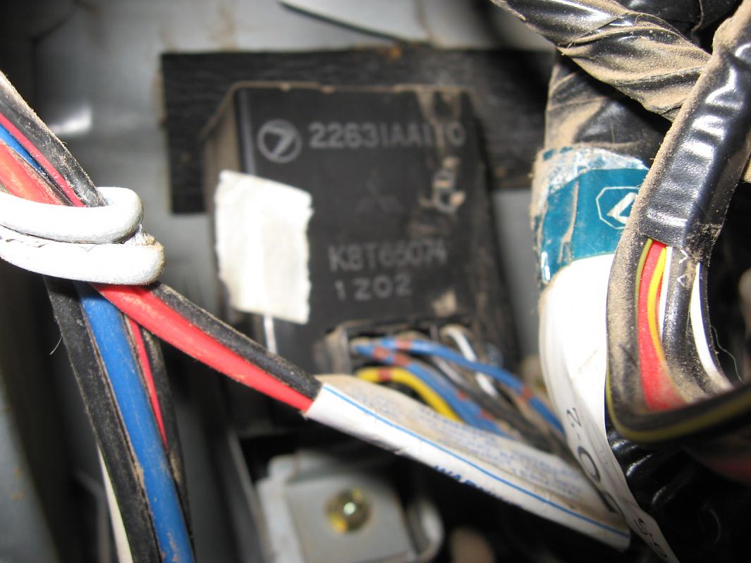

Just as a matter of interest is this the ignition module that is positioned up under the dash near the steering column.

- IMG_1715.jpg (91.44 KiB) Viewed 3162 times
