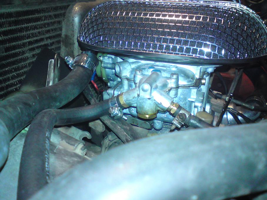

I have recently had a webber carby put onto my brumby. When i picked it up from the shop they advised me that there is a flat spot, when in first as you initially accelerate ( they put it down as wrong a/m carby). Also i was advised that the carby has two pump inlets but the third was missing??????????? The car drives way worse than before, far less power and it is eating more fuel:mad:. Please Help.

Not sure what you mean by "wrong a/m carby"? What type/model is it? We need a bit more info. However the shop you took it to would have given you an option/price to fix it no? Is it genuine weber?

A picture says a thousand words, and half a dozen pictures of this setup would be great. It would be interesting to see what they've done with the fuel lines and also the crank case ventilation system.

and yes what model weber is it, pictures would be great.

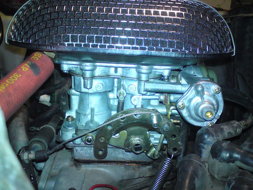

Hi Guys i have tried to attach two photos of the 32/36 dgv Carby, hope it works and i hope it helps.
I took the car to Hervey bay and limped it back home. the Gremlins are still there. While i was on the road i contacted the mechanic and told him he will see the car soon, I then called weber performance and gave them the mechanics Ph.No. so hopefuly they both can figure somthing out??? Thanks again in advance for any insite that you can provide... If the photo's don't work i will try again soon.
Posts: 12716
Post by El_Freddo » Wed Nov 16, 2011 9:24 pm
Yep photos worked:
That is one very shiny carb you've got there!

The Weber should have just One fuel line attached, my own experience teached me to Not use the Return line and leave the hose open, while the carb's return should be Closed.
Have you checked the Jettings? ...
By reading what you wrote, I'm almost sure that it has one of these issues:
  • Wrong Jettings, or
  • Misplaced Jettings.
Those should be:
  • Around 120 / 130 \ 140 in Low Stage (Primary)
  • Around 140 / 150 \ 160 in High Stage (Secondary)
Also, the Choke could be Stuck and not workin' properly.
I Kindly suggest you to Check that and give us Feedback about what did you find, in order to Help you.
Kind Regards.
Post by RSR 555 » Fri Jan 20, 2012 8:21 pm
Put a set of small vice grips on your return line. This will eliminate if this is the issue. Personally, I think it's more likey over fueling and really need to check float height. I have a great tool that replaces the spark plug and allows you to see the fuel burning in the combustion chamber. This would show you if its a fuel or vacuum issue.
