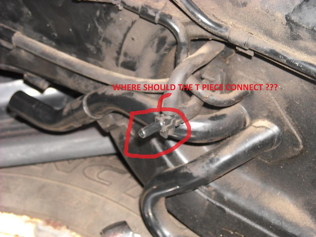

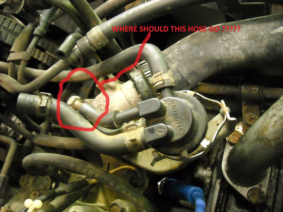

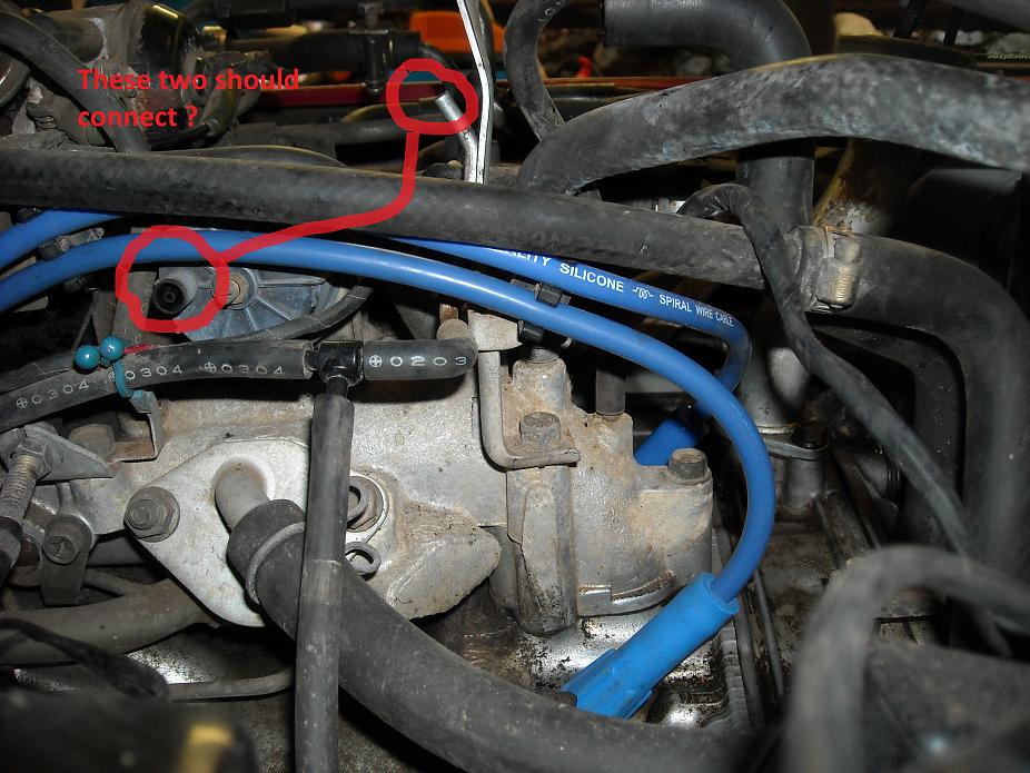

Hello , I just picked up my first Subaru L Series Wagon and have a few problems . There are several disconnected hoses around the carb and wondered if anyone knows where they go ?
The wagon is a 93 with 270000km's on the clock .I have just changed the original leads , plugs ,oil ,fuel filter and adjusted the timing to 12btdc.
Any pointers would be appreciated :)

In the Third Photo, The big grey round one is the Accelerator actuator for the A/C, so when you press ON the A/C it will speed up a little the Idle...
It's hose comes from the Solenoid, located next to the Vacuum acumulator Bottle which, on our Left hand drive Subies is behind the strut tower on the passenger side... I'm not sure if that is located on the Other side on that Right Hand Drive Subies there.
But I Hope that can Help...

Wow, there's been some funky work under that bonnet! I can't remember where all those hoses go, but in the third photo with the AC idle up solenoid (that Loyal 2.7 got onto) there's a hose with another hose shoved in it held with a hose clamp, this isn't correct either, I'm not sure where it should go. Probably best if you do a search for the L series manual online (Toonga might have a PDF copy somewhere) and check out the diagrams in there of the anti pollution gear - that should give you some idea as to what's supposed to go where.

The middle one with the bolt plugging the hose is technically correct, ie, it should be blocked, though the original Subaru rubber cap is obviously missing.
I will try to have a look at mine when the engine cools down and I can get my head into things.

I have connected up the A/C idle up as directed by Loyale 2.7 Turbo and am just left with that T under the airbox and the metal pipe ( which has strong vac when the engine runs ).
Appreciate you taking the time to sort those pic's out El Freddo , that hose is like that on each end and looks like it was put in to replace a perished hose . I have the manual on the way so will check it when it comes . By the way amazing work on your wagon , I just watched your video on another forum and am very impressed .
Thanks for letting me know that hose is ok Cliff. If you could check where the other one goes when you get a chance I'd appreciate it .

I have this morning pulled off my air filter to have a look underneath. Way more complicated than an EA81 engines air filter but I have managed to ID your hoses.
In picture No 1 were you are asking "Where should the T piece connect" it infact goes onto the top, silver (in your picture) pipe in your picture No 3 where you are asking "These two should connect ?" So, the answer is NO, AC idle compensator does NOT plug into the silver pipe.
Your picture No 2 as I mentioned yesterday is a blank. It is just your blank is a piece of hose with a bolt in it.
To finish off the AC idle compensator in your picture No 3 goes off towards the drivers side of the engine bay and makes its way to a switch that is located between the front, drivers side strut and the cars firewall. There is a white canister next to the switch. It is located in front of the cars compliance plate. This hose from the AC idle compensator goes into the rear of this switch, ie, the compliance plate side of the switch right next to where 2 wires plug into the switch.

Post by newscooby » Sat Jan 21, 2012 7:31 pm
Thanks Cliff that's very helpful you have covered all I needed to know , I can now correct the errors.
