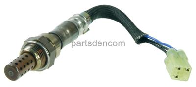

Yeah grab a new sensor from ebay. Any 3 wire sensor will do, you just have to swap the connector so it plugs into your loom
http://www.ebay.com.au/itm/SUBARU-IMPRE ... SOR-3-WIRE
Thanks Gannon, so is there only the 1 in the exhaust? Never heard of 1 on the inlet either. Does the turbo one this links too on fleabay fit non turbos as well?

Sorry Gannon, just read the rest of the ad, Doh! Will try to get the numbers off it and search fleabay again or get in touch with this mob, cheers!

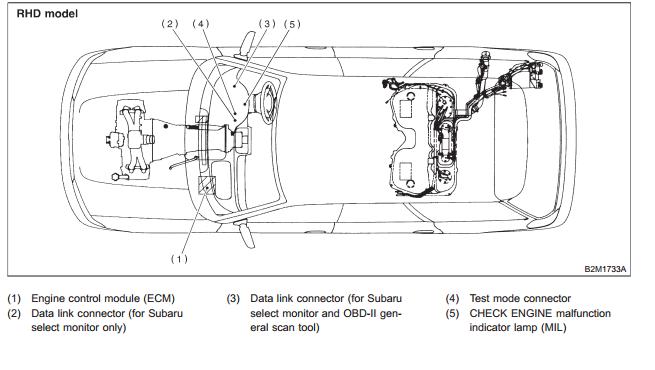

Ummm.... cant find the ECU in the Pass footwell, not behind the kick panel, could it be under the drivers kick panel near the fuse box? Book doesn't say so.
Suby Newbie
Suby Newbie
The ecu is located under a metal plate where the floor angles up towards the firewall. You will have to remove 3 bolts to remove the metal plate to get access to the ecu

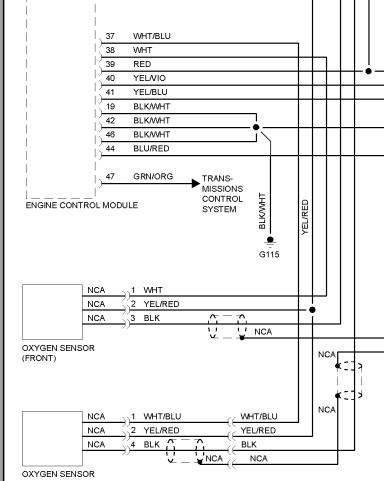

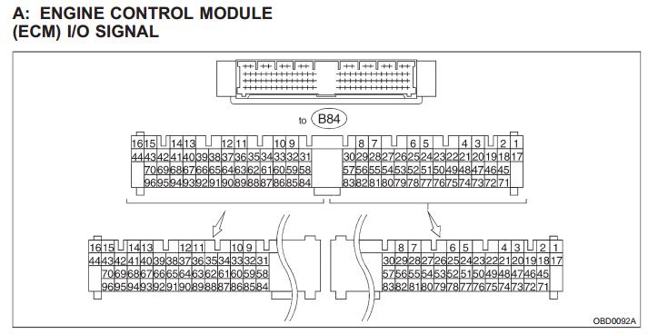

The white wire going to pin 38 is the one you are testing. Under acceleration, it should be up around 0.9v (rich), when backing off, it should drop to around 0.1v (lean) and while cruising, it should alternate back and forth, showing the ecu is in closed loop mode
