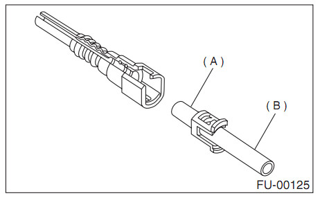

Hi, my 2004 imprezza 2 litre fuel pump is howling its head off, and ive had a look at where its located to renew it. The outlet (pressure hose) from the pump has an unusual looking fitting on it with 2 brown spring loaded plastic tabs (1 on each side) Is it simply a matter of squeezing these tabs to unclip the line, or is a special tool required.
Yes I know i have to de-pressurise it first. I have a selection of various size quick disconnect tools but this fitting is new to me. Thanks and apologize for double posting, the 1st was in the wrong spot

Can you post a pic please?

I found this picture in a manual on the net. Once you know how it works its easy. The brown coloured tabs I referred to are meant to be replaced each time they're undone. Once the fuel pressure is depressurised you squeeze the 2 brown tabs and the fuel line slides off the pipe leaving the two tabs (called appropriately in the manual "a retainer") still clipped to the fuel pipe. Very clever.
