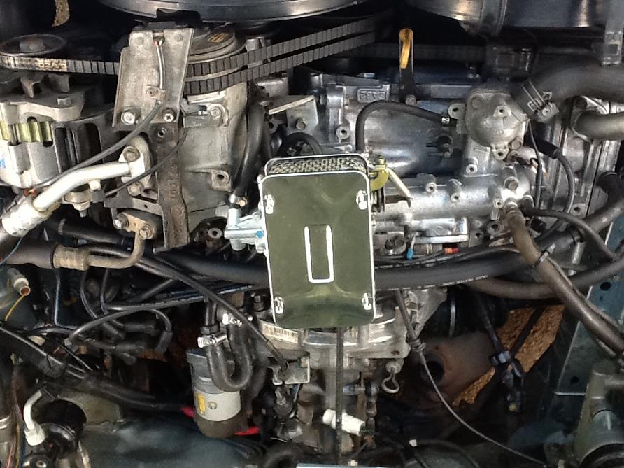

As per the title, the L had a new weber 32 36. Runs great so far but can't nut out where to run the vac advance for the dizzy from. Removed that series of thin piping from under the manifold where I used to come from.
At the moment I have it plug into a spot on the manifold but when you give it throttle the dizzy actually retards, as opposed to advancing. So.. Where do I port it from?

Weber is in place and running great. I also went through and removed all the old emissions and vac stuff I no longer need. Finally some space to work in the engine bay
What a difference it makes to everyday driving: smooth idle, much more responsive under foot and a noticable improvement in power too (mostly torque at low revs)!
Very happy.
