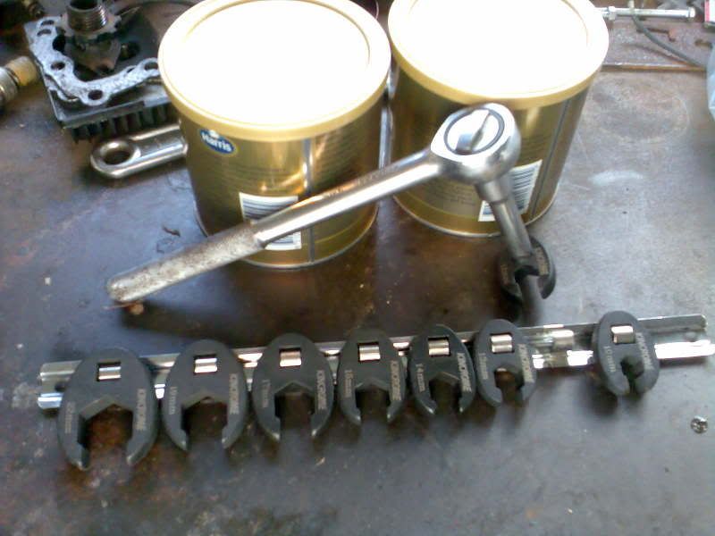

When I repaired my rack, I came unstuck with this problem too. Got on top of it by purchasing a set of metric crowsfoot 3/8 drive sockets. Still difficult, but still doable. Kinchrome make a set, fairly reasonable price.
I'm not understanding what you mean by these sockets.
How do you fit a socket over a nut with a pipe sticking out of it?
I've got a set of pipe spanners I've had for 10 years & protect my life with them, but I can't even get the thread started & I don't want to strip it or cross thread it.

I came across them again in the shed, here is a pic of Crowsfoot sockets, suit 3/8 drive.wagonist wrote:I'm not understanding what you mean by these sockets.
thanks for posting that I always wondered what these so called "crowsfeet" sockets were. BTW i found the only way I could get the lines hooked up to the rack recently was by dropping the engine crossmember. I wished i'd done it before wasting an hour. Just put a jack under the trans undo a few bolts & ur there
