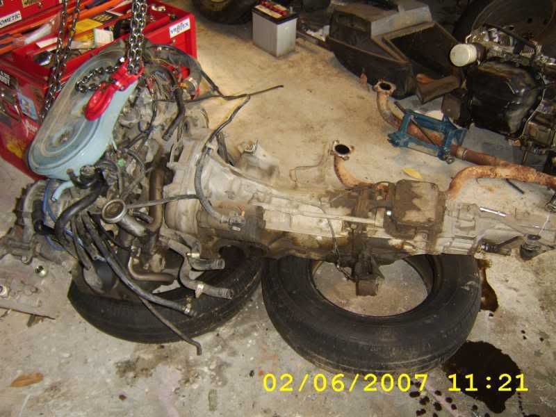

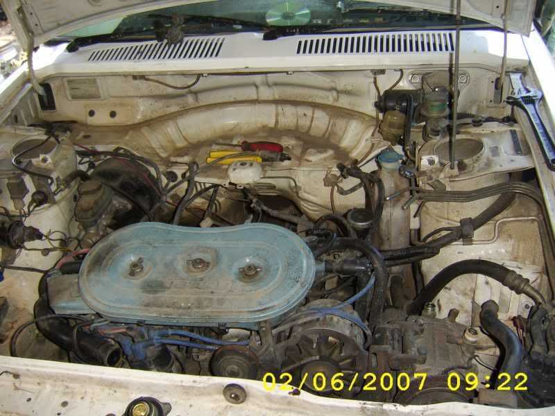

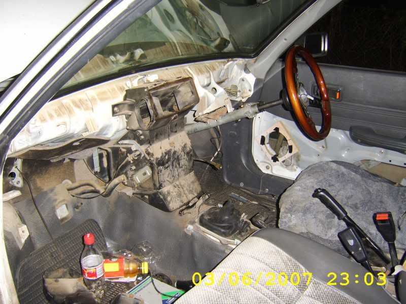

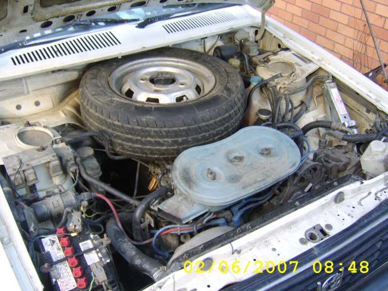

Just in case anyone wants to know here's a before pic.
Old and busted
Motor ready to come out
Motors out
16yrs of grunge, cleaner than I expected...
Dash out
Old and busted
Motors out
Dash out

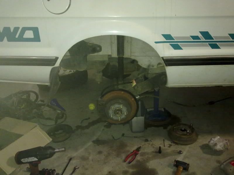

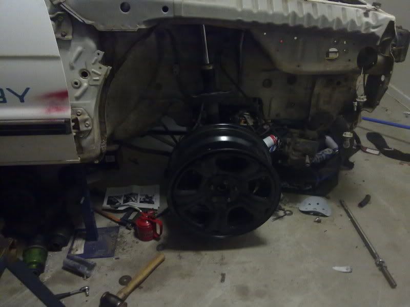

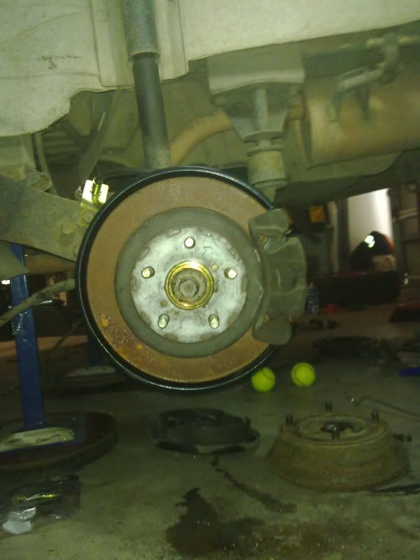

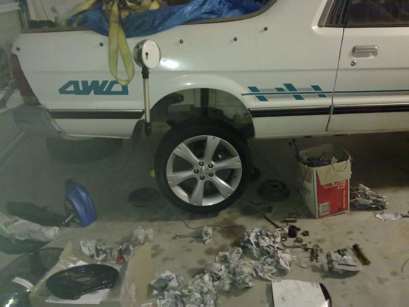

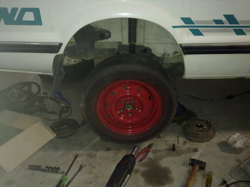

Cross Bred 5 Stud brake kit
LHR kit fitted
RHR fitted

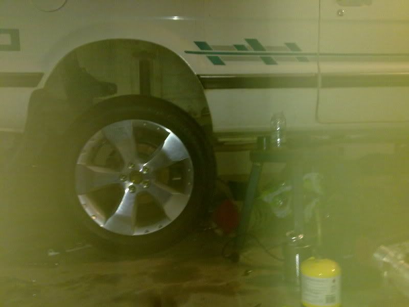

Red liberty wheels anyone?
MY07 2.5I Liberty mag
MY09 Forester XT Mag
RHF mocked up with liberty strut and 16" foz steel rim and no tyre
LHR kit fitted
RHR fitted

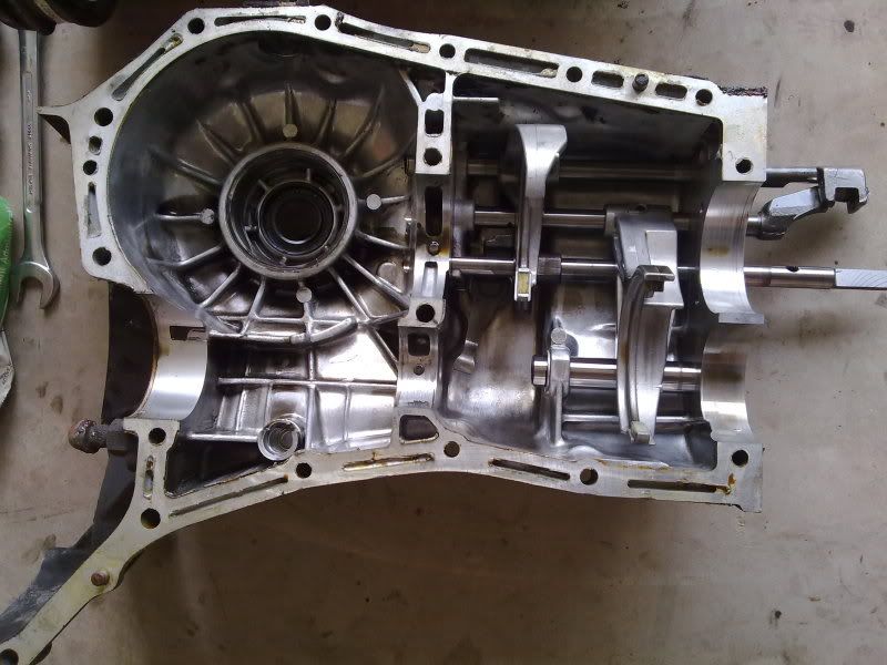

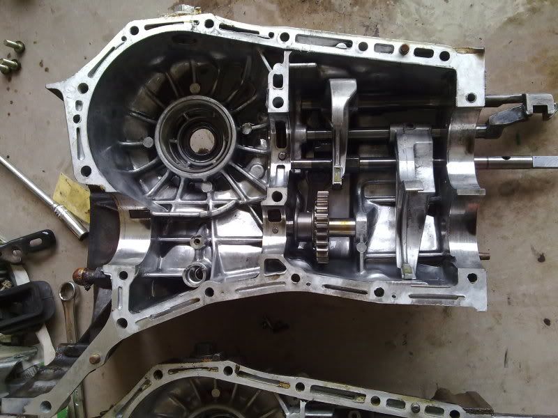

Liberty D/R Case
L Series 5sp D/R Case
There's not as many pic of the gearbox as I wanted to take because I forgot to take pics, I've still gotta put the extension housing etc back together so I'll take some pics when that happens.
I'll post up more pics as they happen...

- AlpineRaven
- Posts: 3682
Awesome.. getting there...
How did you find working with the gearbox? spliting & converting the low range etc
- AlpineRaven
- Posts: 3682
Oh which Liberty box is it?
