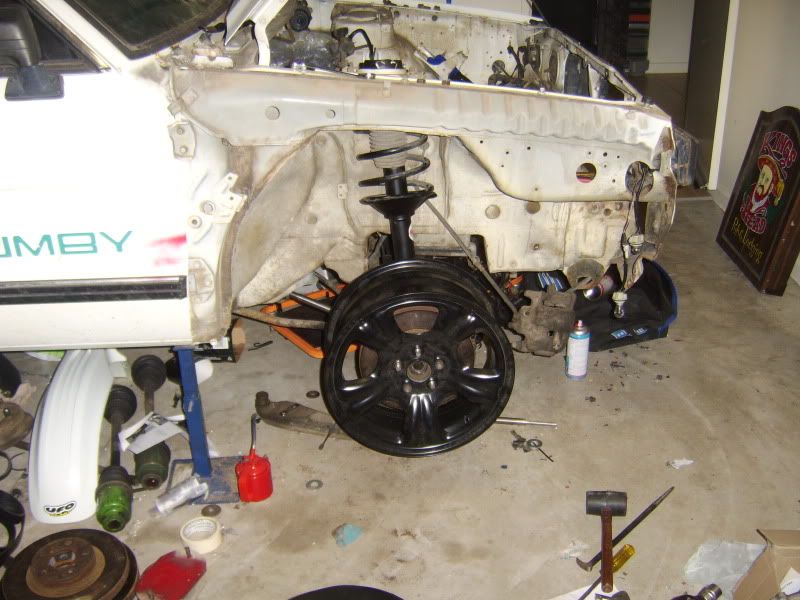

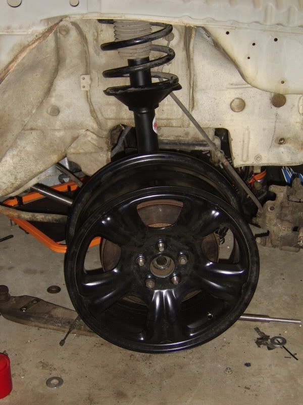

well I'm officially disappointed, I finished assembling the front struts in the ute and got the cross bred steering adaptors worked out, went to fit them to the car and found that they wont fit with the lift block on top of the strut, apparently there's not enough movement in the bottom ball joint to get the angle to fit both bottom strut bolts. took the lift block and it's all good, just...
for those interested, I'm running a 2" lift kit with a cross bred 5 stud kit using L series lower control arms, liberty hubs with camber adjustment and forester struts and springs...

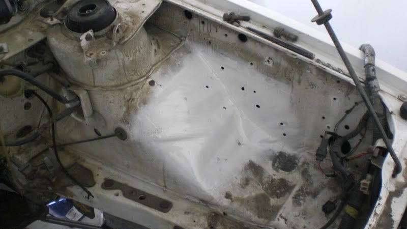

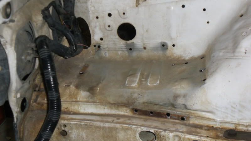

Ok so small update, I started working on my ute today and was planning on spending the whole day on it seeing as its our show holiday but got side tracked helping the Mrs clean up my parts room after the cat pissed on the tarp I had down to protect the carpet.
Anyway I managed to get the jack holder out
Then the battery tray
Then out came the steering rack after some more spot weld drilling
