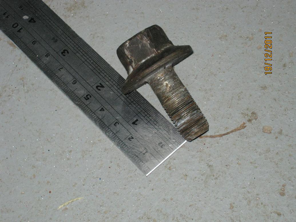

The bolt is not vey long nore is it hi tensile so you should be able to get it out easier than you think.
- IMG_0024.jpg (107.89 KiB) Viewed 5899 times
Thanks for the pic, I still have about 10 threads left on my half of the bolt so shouldn't be too much left in there.
