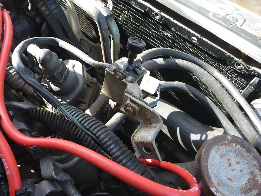

Hi guys,
Thanks for the responses. I have attached some pictures to this post, hopefully you can see what I mean by them. I was sort of leaning on the suspension tower on the drivers side looking forward-ish when I took these.
I think this is a boost controller, however it's just swinging in the breeze next to the oil filler cap and not bolted to anything. Where is this meant to be?
[ATTACH]4061[/ATTACH]

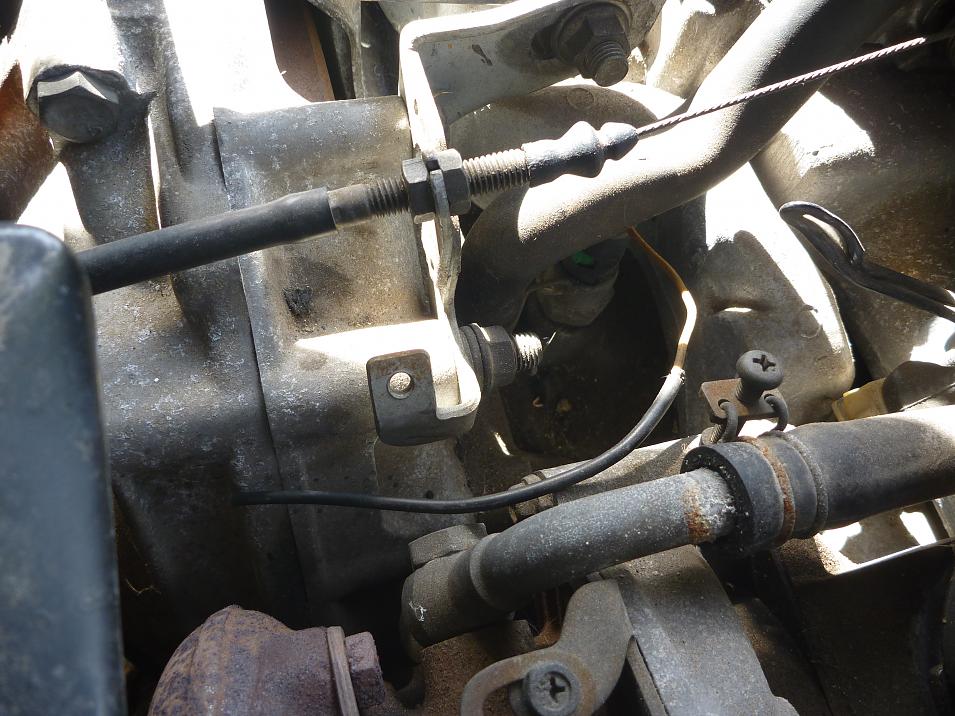

Secondly there are these two vacuum lines plugged up with screws, I'm not sure where these are meant to be going.
[ATTACH]4062[/ATTACH]

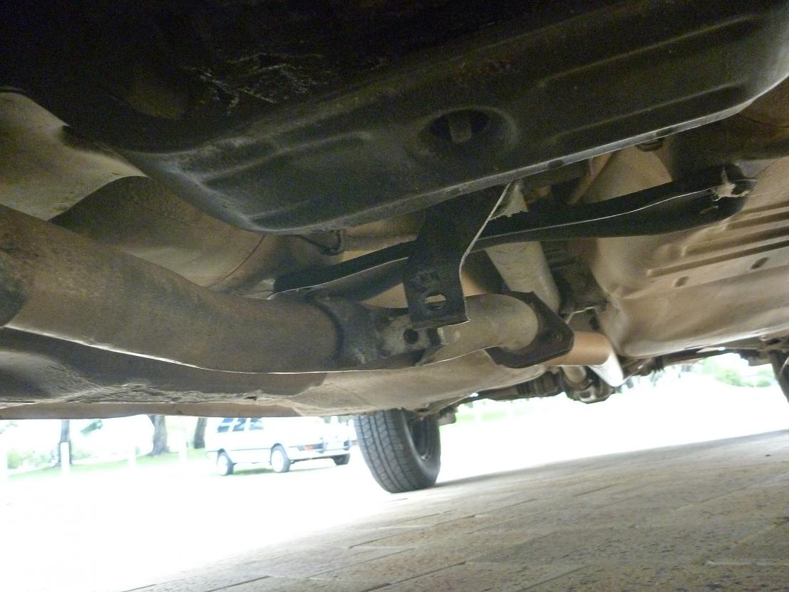

After reading your post I had a facepalm moment. I had read that Touring Wagons came with turbos but hadn't realised that they had not been delivered in Australia. I assumed as is was a factory turbo that this was the original engine, but I hadn't thought of it as a transplant. This probably explains this photo then:
[ATTACH]4063[/ATTACH]
I thought maybe there was just a bracket missing but maybe it doesn't line up at all because the exhaust is different? And yes, that's another L Series in the back ground - my current daily driver

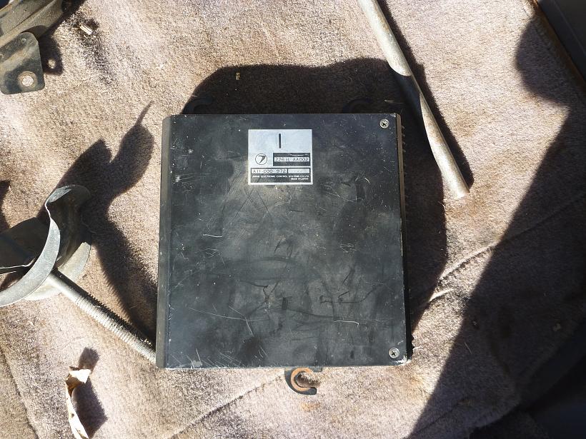

And then there's this thing I found under the seat while I was cleaning the car out this afternoon ...
[ATTACH]4065[/ATTACH]

OK, those mystery vac lines in photo #2....
the metal supply with a bend in it then plugged by the straight blade screw/bolt is meant to be connected to the EGR control solenoid and the tube coming out at right angles of said solenoid. I suspect the other vac line plugged up with philips screw is for the second tube coming straight of the solenoid. How someone has hooked your pictured solenoid up otherwise I do not know - maybe enough to fool the authorities
EGR is good for the environment when the unit works correctly in its firrst 20,000km or so but then somewhere later they gunk up and do not operate as intended. They gunk up with sooty carbon that is as hard as billy-o. Don't believe the 'get another 10kW by plugging up the EA82s EGR unless you read into it that you get another 10kW at its operating range not top end demands
Also starting to think if you found that ecu loose, may be an aftermarket ecu running the engine. I spied a fellow over a year ago ( need to catch up Leonard if you are reading this !) with an import L wagon turbo beast running aftermarket ECU that does not use boost control from this sensor, doubt it pings, yet goes hard when his mechanic was drivng it - I couldn't catch it!
OK, on closer inspection - that solenoid with one hose, one vent, likely a second hose not easily seen in the pics ? - that is the solenoid for charcoal cannister control usually bolted further back on turbo side of the manifold, further down amongst crap.
Looks like you are missing the EGR solenoid!
Not something that would make car feel like it is not running right - neither of them actually. I think the char can solenoid is an update not on 85,86 efi , more late 8 onwards

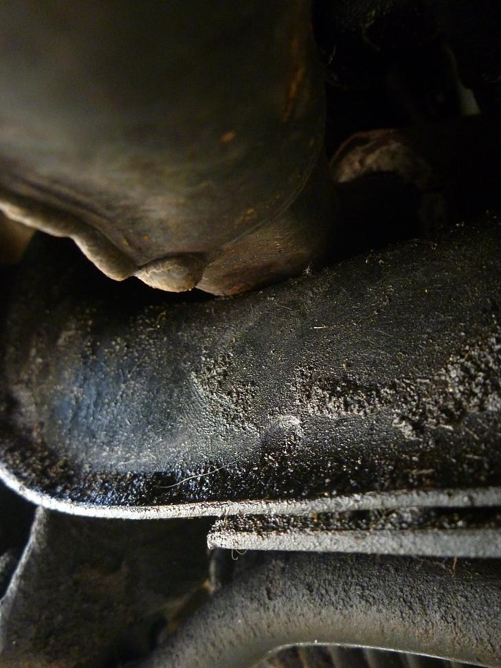

Last photo to post: I think this exhaust is very, very close ...
[ATTACH]4078[/ATTACH]
If the exhaust is not touching the cross member then it's not missing by much. I don't think it's touching as there isn't any vibration through the car when it's running, but just going on the noise it might be hitting on start up. I'll have to stick my head under there and have a look when I start it.
Yes, it has a few oil leaks ... it needs a bloody good clean under here, but I'll get to that

I think Steptoe is on the money re: EGR.
The engine crossmember has not been modified to allow for the turbo engine pipe. A well thought out EA82 turbo conversion will either have the turbo Xmember retro fitted or have the N/A xmember modified to allow for the turbo exhaust manifold.
It may not be touching or not by much, but it aint good.
The engine on one side at least is hard up against the xmember, therefore the engine mounts would not be doing a very good job damping vibration through the body etc.
Just my 2 cents worth:)
Hi FujiFan, thanks for adding your two cents! I'm in the dark with what I've bought here and I'm still trying to work out if it's a good buy or I should move it on, so the more input the betterFujiFan wrote: The engine crossmember has not been modified to allow for the turbo engine pipe. A well thought out EA82 turbo conversion will either have the turbo Xmember retro fitted or have the N/A xmember modified to allow for the turbo exhaust manifold.
I guess finding a turbo cross member would be difficult now given the age of these things. What is the N/A cross member modification? I can imagine a big hammer, but hopefully it's more scientific than that?
