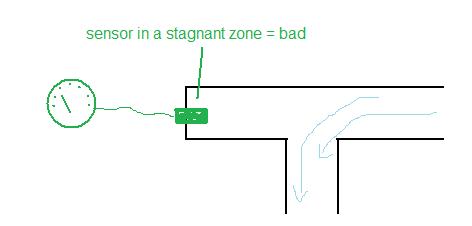

Not quite sure what you mean there.guyph_01 wrote: i have my sensor as a u shaped bend from the
If the sensor is in an arm of the T that is blanked off, nothing will flow into that arm, so the sensor won't get a good reading. The sensor needs to be in the path of moving coolant, like right in the middle of that T piece.

And the pic/5yo drawing of the T piece from Dane: My mechanical sender has plenty of flow as it extends into the middle of the T to where the coolant flows. It is one very responsive temperature guage! I don't know how far in the electrical units go, but if its anything like the factory sender units you'd probabily be better off shaping a pipe to suit, then drill and tap a hole for the given sender to fit into. I hadn't thought about tapping a hole near the factory sender because I couldn't find one on the EA, then came up with something that worked and didn't think anything of it when the EJ went in.

Oi! 5yo drawing indeed. That's a serious diagram made in PaintCADEl_Freddo wrote: And the pic/5yo drawing of the T piece from Dane: My mechanical sender has plenty of flow as it extends into the middle of the T to where the coolant flows.
It did cross my mind afterwards that your mech gauge sensor is probably long enough to reach right into that T. So you probably are getting a good indication on your gauge, and it's the mega radiator keeping the temp a bit on the low side.
