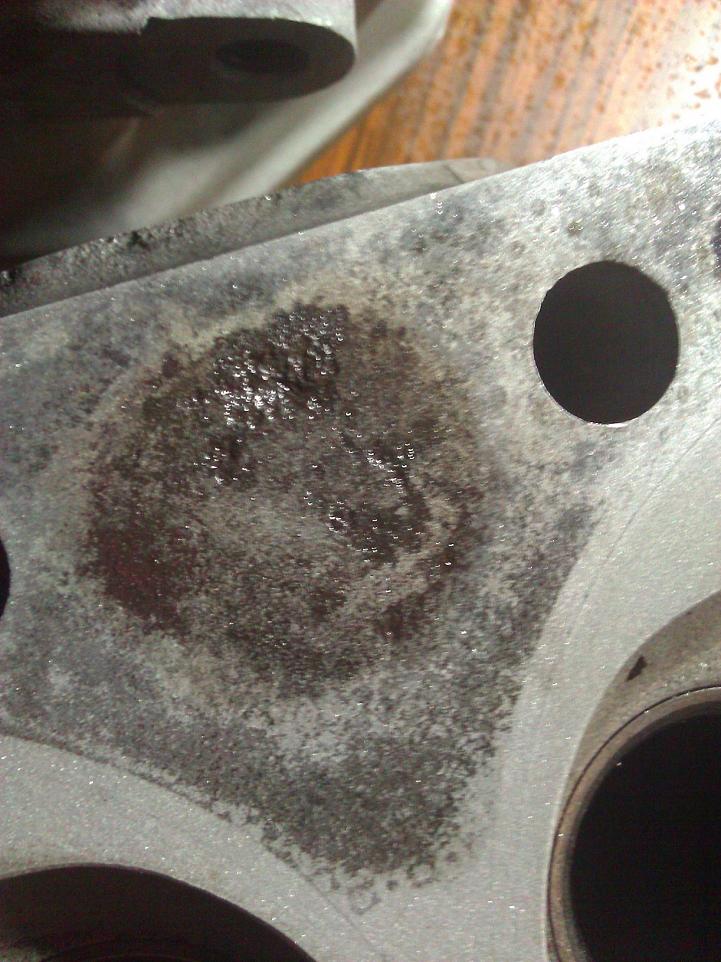

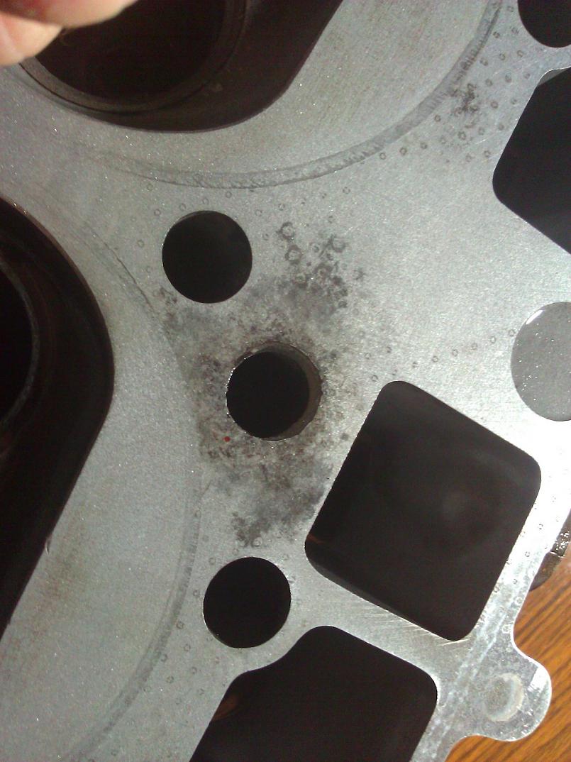

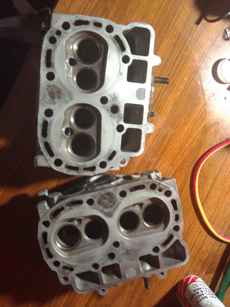

Hey Fellas,
After a light sandblast today I got out the elbow grease and gave the heads a once over. I think Im gonna need to surface them. Too corroded. What do you think?
Doug

Get yourself a nice thick flat sheet of glass or stone (about 2 -3 times as big as the head) and cover it with a coarse grade of garnet paper (100 -180) then using a figure of 8 motion and water to keep the paper usable you can face your heads.
While most people recommend skimming them, this works on the same principle and doesn't remove as much meat from the heads.
